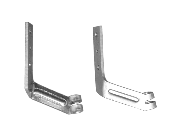

Do you have a picture? I may have some extra pieces.
Do you mean these? I am missing passenger side one too
And after you get that bracket welded on and back in the door, make sure to put a piece of foam or felt between that and the round rod that rides in it. Otherwise you will still have a rattle.
Like Joel said above for the rod. I have found shoe laces work great for that just cut off the ends and slide them on!
Guys...
Thanks to BeeKeeper I called Tonys.. he had the bracket and stud. The kit comes with a wax showlace to wrap on the post...and the bracket comes with 2 small screws that attach it to the window frame....
I think it will be here by weekend I will report back THANK YOU
