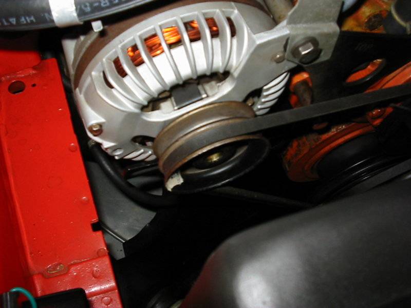

The OEM correct hemi alternator pulley 69-71 is double groove 3" part #2095059. I see a lot of cars with the aftermarket double pulley on aftermarket alternator. Works, just not OEM appearance. Correct pulley picture attached, notice how the hub for removal and installation is recessed into the pulley; not sticking out like a nose on some of the non-hemi versions.
