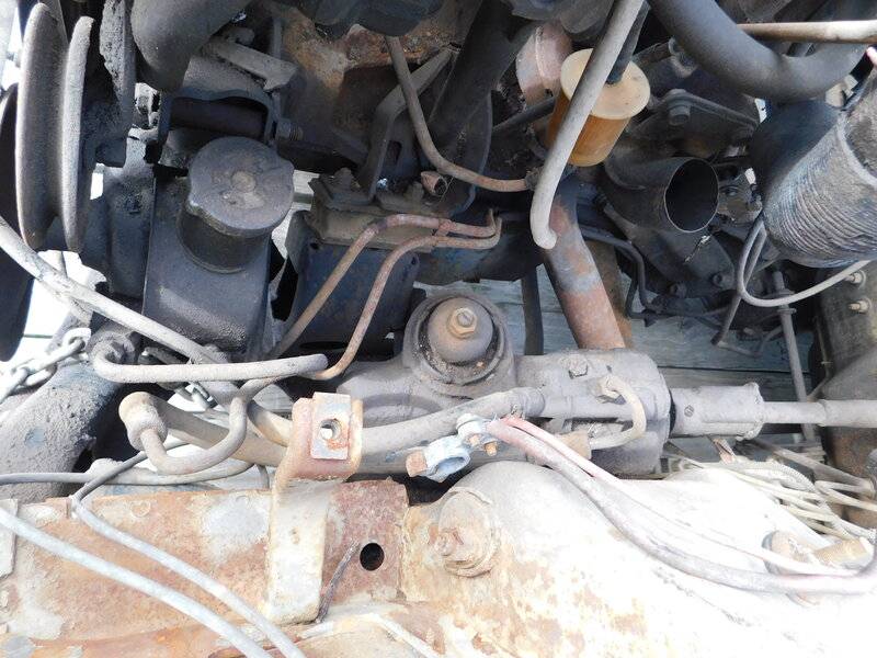

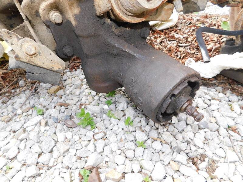

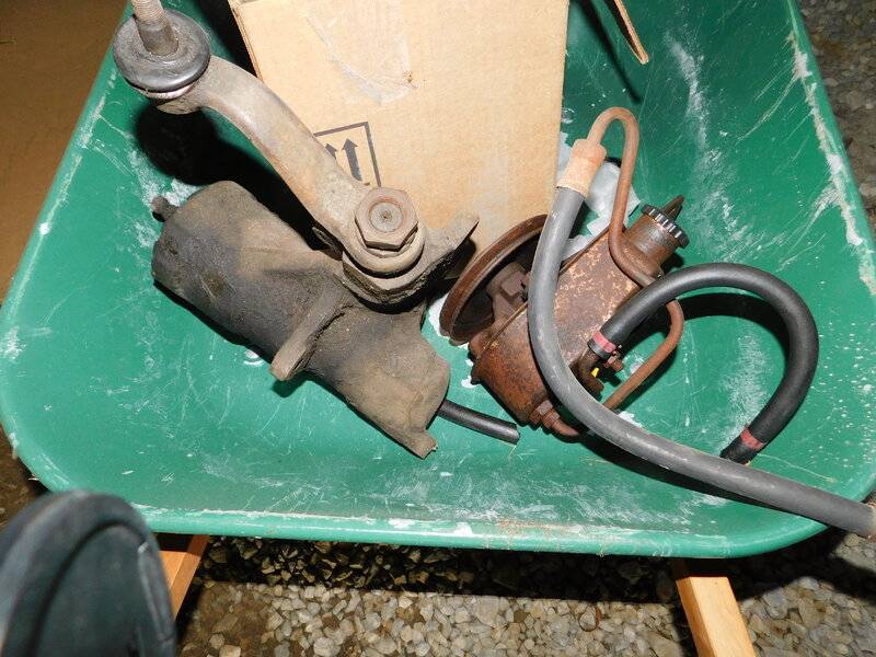

I thought I would add pics cuz I hear you guys love pics!
1st is my 6 cyl in car
2nd box on K-frame out of car
3rd is box and pump
