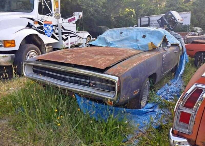

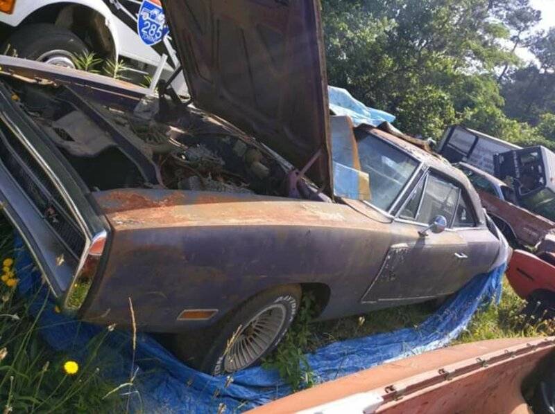

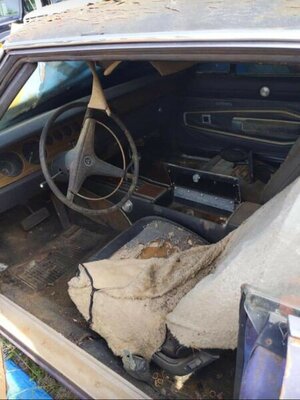

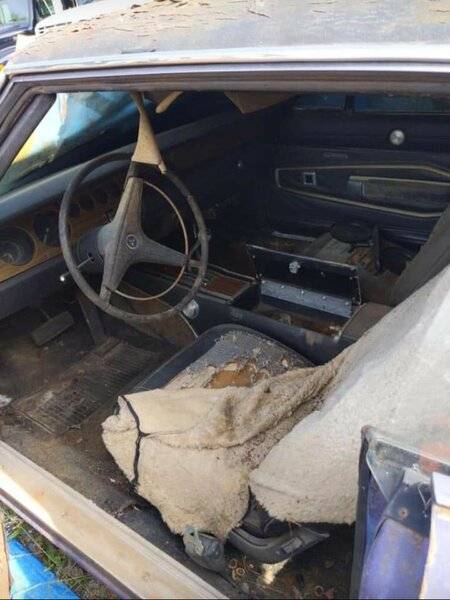

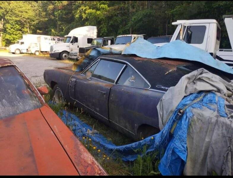

Interested in getting this charger R/T. Seller wants 11k for it. What should I look for on this car besides the frame rails and Vin?

Look for rust around the back glass and the trunk. As well as floor pans front to rear and quarter panels etc etc..
From what I see, take it for 11k as quickly as possible and run.
That looks like a nicely optioned Charger R/T, I would close the deal on that one. Bring 11 grand, but flash 10 grand in cash and see if he takes it.

FC7, console auto with power windows???? You better act TODAY!
Reasonable price to purchase but there are untold areas that probably need rescue, trunk floor and extensions, quarter panel repair or replacement, rear window lips, inner wheel wells, possibly cabin floor patches or complete replacement, frame rails, torsion bar cross member, front aprons, lower valance...etc. the list could get big in a hurry. You could easily be looking at 10-15 thousand in sheet metal repair/replacement before you know it. With all that said, it's not for the faint of heart or shallow pockets brother but in the end it's a RT Charger so...

Most 68 to 70 Chargers will need to have the rear quarters, trunk floor, trunk extensions, outer wheel wells, Dutch panel, rear crossmember, rear valance pan and corners replaced. That's almost guaranteed. Some need rear frame rails, tortion bar cross member, rocker panels and floor pan replacement as well, sometimes even roof skin and roof structure repair as well. Until the car is dismantled and you can see how much metal work is needed, it can be hard to tell how much is required to be replaced. Check all of the areas I stated,as well as the cowl, firewall and inner fenders as well. By looking at the photos, I would say that it will need atleast the first part of what I stated in this thread. Most of the 70 specific parts appear to be present, and in restorable condition, and those parts can be expensive and difficult to locate. Other than the front valance pan,and front bumper, none of the 70 front end parts are being reproduced. So it is a big plus that those parts are present, and restorable.
You are looking at $30 - 60K to restore it depending on how bad it is (or good depending on your view point) and how good (accurate) you want it to be, who does the work, etc. Over the top 100 point restorations are into the 6 figures if everything is farmed out to a very good shop. Not a real quick endeavor either, most good shops are backed up several years from what am hearing, if you are going to do it yourself or most of it, then it could be quicker if you have the time and skill to do it.

Prices for these vehicles have only gone up in recent years and the cost to restore has gone up as well. I see it is in a field, but getting under the car is crucial in a pre-purchase inspection.
