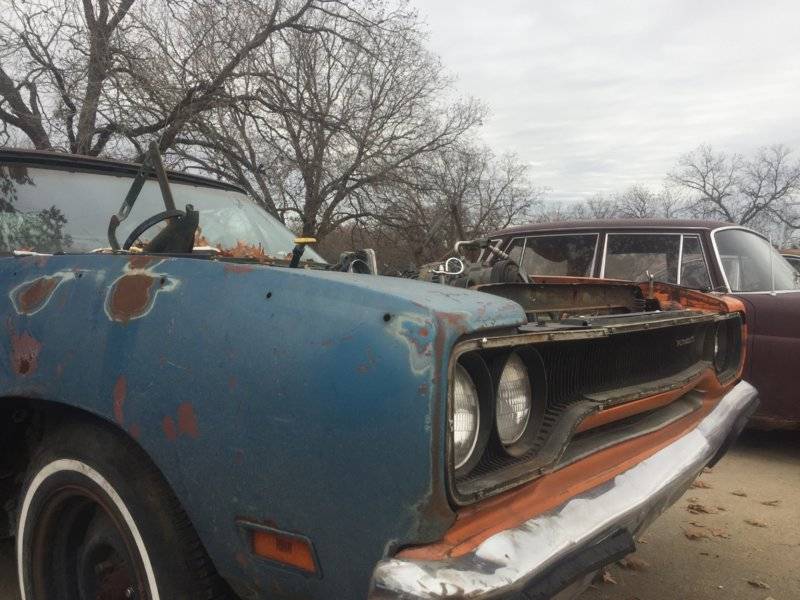

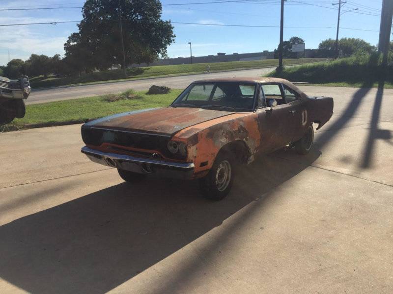

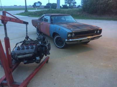

Ratrunner? Not sure if I like the sound of that. Its a 70 383 4 speed car, bucket/buddy seat, hood pins and roadrunner décor package car. Wanted a 70 roadrunner post car since I first got into Chryslers. Have one high dollar 70 project already, so decided to do this as a cheap build.
Got an organ donor for it off craigslist, 5.7 hemi automatic 2003 dodge 1500. Putting the motor, trans, and every wire (except ABS, airbag, and door wiring harnesses) from the truck into the roadrunner. Little overhead console, shift linkage and steering column going in as well. Just put in a sweep dash to be cut up for gauges and all the controls the truck had. Currently at a body shop, but ill be doing all the work to it.

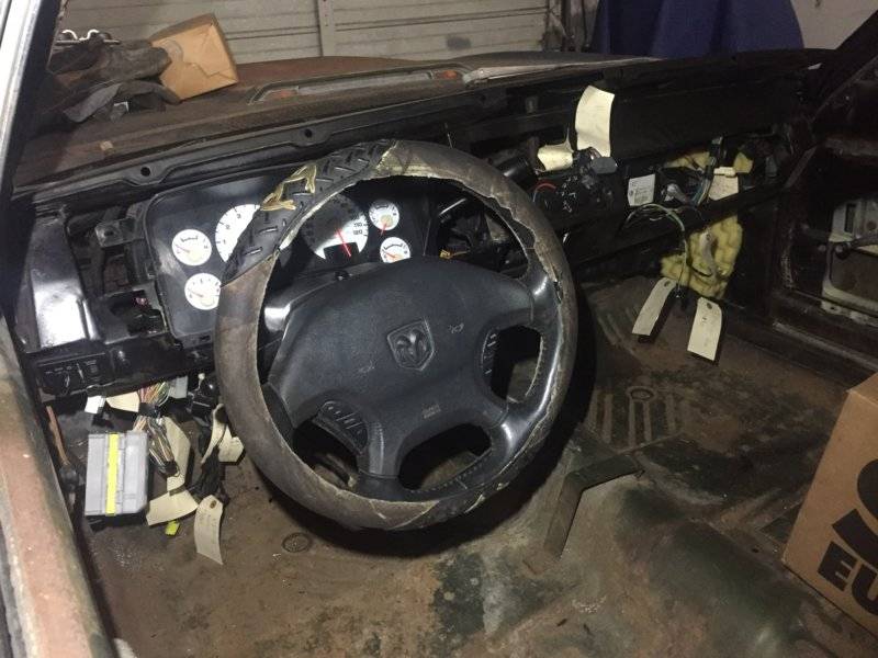

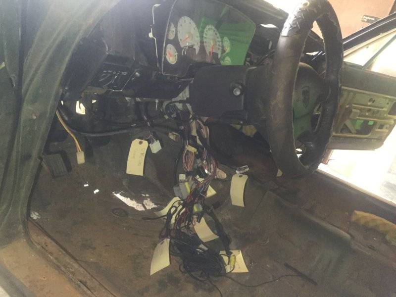

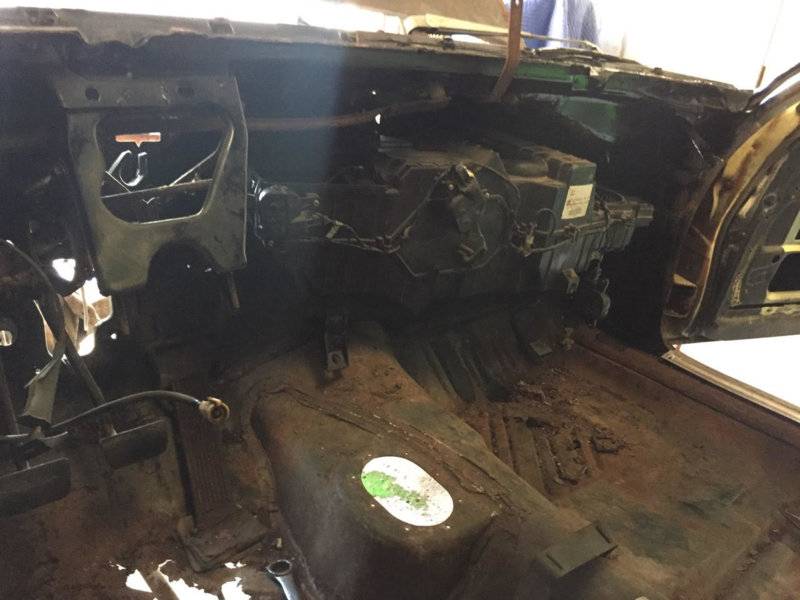

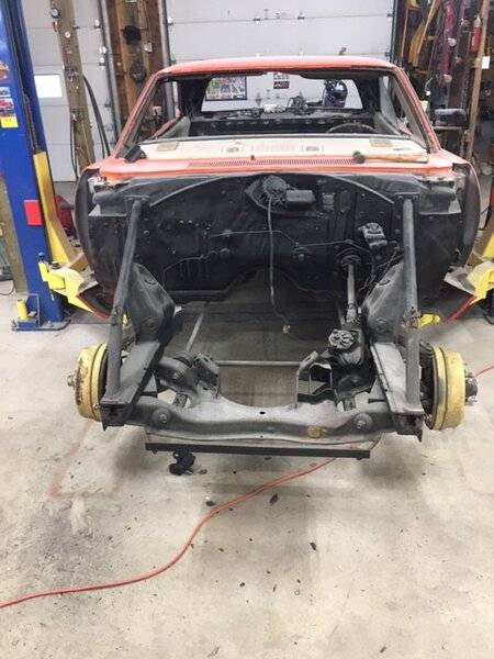

On Friday I got the car's interior gutted, and fit the AC box under a sweep dash. Some things were cut off the box, but should have enough for selecting AC and heat with either defog or dash AC vents. Also clearanced the box for full wiper motor rotation. Monday should give me time enough to lay out the interior wiring harness so I can figure out AC and light control locations, as well as fitting the gauges and steering column.
After that, going to pull it all back out to fit the motor and transmission, (cutting the transmission tunnel to leave enough room for the transmission) followed by putting the floor back together and patching its rust holes, fixing the drum brakes, and setting up the gas tank. All in all, should have well under 10 grand in what I expect to be the junkiest looking car at local car shows. Don't plan on doing much exterior wise. May end up DA'ing the car down to metal then painting it with DTM black, don't want a second car that I have to oil the outside of.

Gauges, overhead console, steering column, and light and AC controls have been mounted for a while now. The interior harness is in and mostly connected. Waiting for the rain to go away to swap the power steering box for a manual one, then connect the column to it.

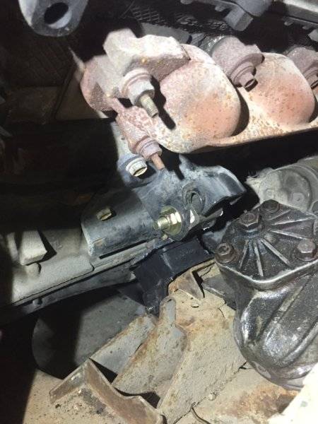

Motor mounts went from DIY to DIWHY (they were solid mount and wouldn’t let the manual steering box clear). So they’re getting cut off for version 2. This time, while still diy, they’ll be polyurethane and will allow the steering box the fit, that’s the dream at least.

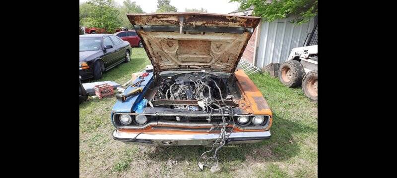

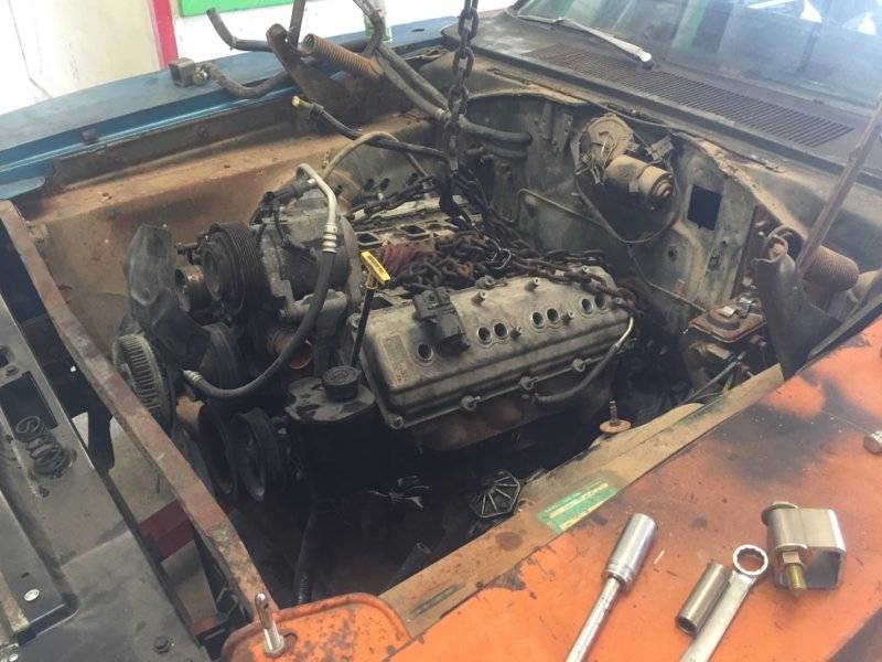

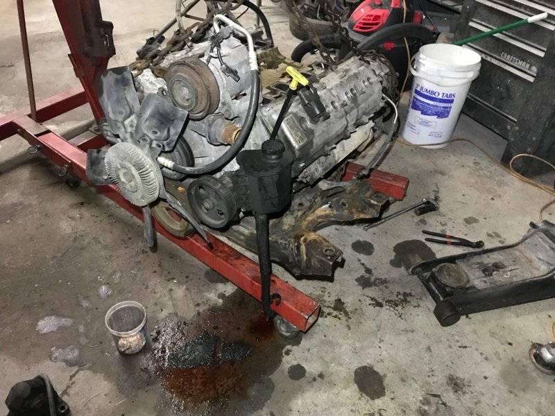

Been quite while since I’ve had time to work on it. Got the motor sitting in the bay for mock up, and should have the motor mounts drying by tonight.
269B7B0D-20B7-46A0-92AF-7D74A011DAA3.jpeg 68FF2C5D-B0F9-47E3-8835-F78BAD641E01.jpeg

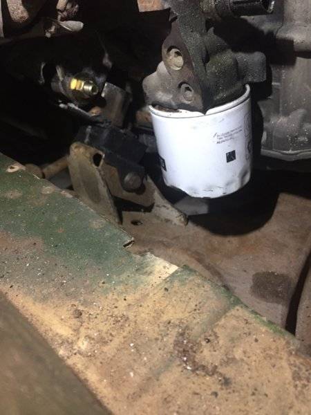

Motor mounts were mocked up (pictured) and are now back out with the polyeurethane drying. Motor sits a little higher than expected, but that keeps me from spending money on the oil pan, pickup and oil filter relocation kit. Can easily get the oil filter off as it sits. Have a rusted out hood that will either get the cowl induction hump built way up, or a massive hood scoop put on to accommodate the ridiculously high sitting ac compressor and alternator. Doesn’t bug me as I should be under 5 in this car running and driving.
Should have the steering column fabbed up tomorrow. Trans mount will come whenever the motor mounts are dried. Starting to come together.

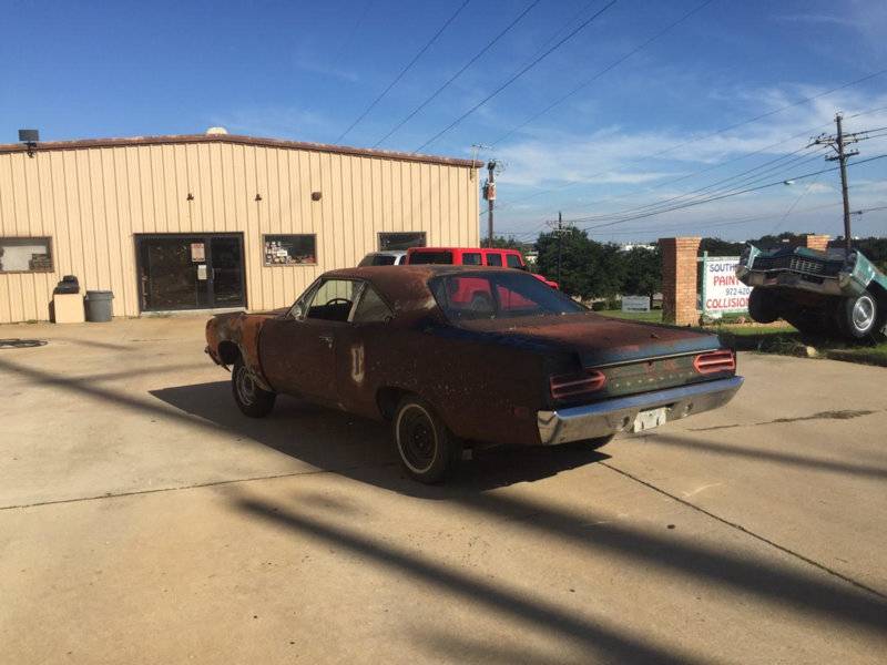

Drug it out of the back and returned it to the shop the other day (first time in many months). Only dropped it off the dolly’s twice.

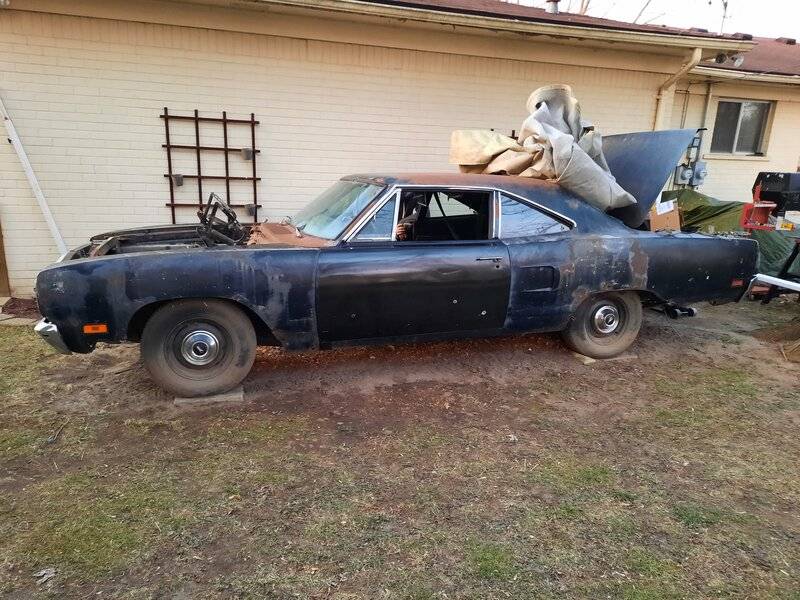

Been more than a year since my last update, but the Ratrunner project isn't dead, just dormant until I get my new shop finished out and get the car moved over there
