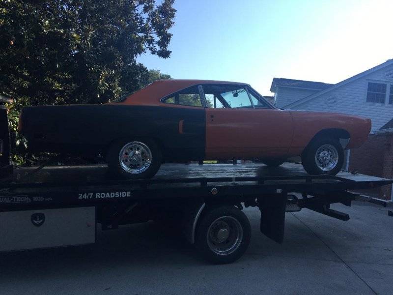

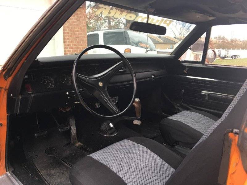

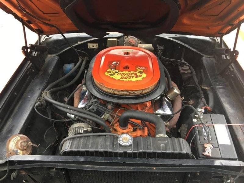

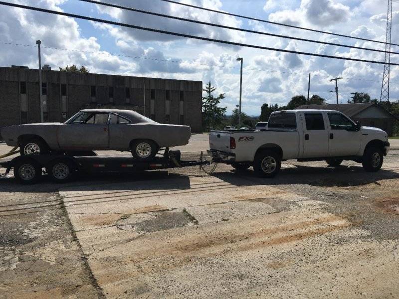

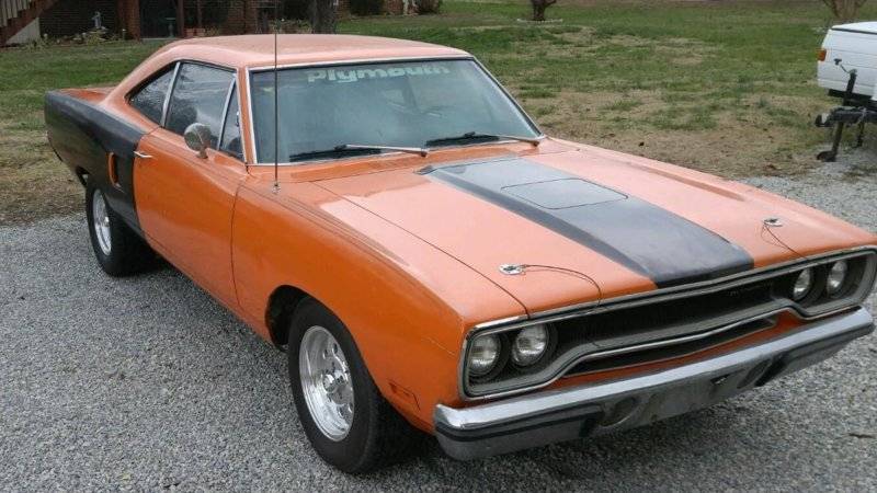

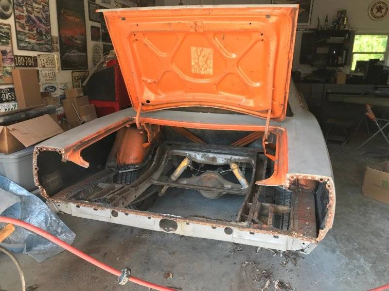

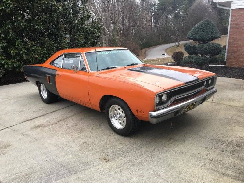

  • Finally starting a build thread for my 1970 Roadrunner. Car was purchased February 2016 after being owned by the same guy since 1999. Car had an attempted repaint sometime in its life and the previous owner had quarters and a 2 piece trunk pan installed sometime between 99 and 2016. He also traded the gull wing for a pair of bucket seats requiring me to find a bench seat and deck lid. Here are the pics starting from the first picture I took after pulling car out of his garage, the ride home, arrival home and then up on blocks to begin disassembly.

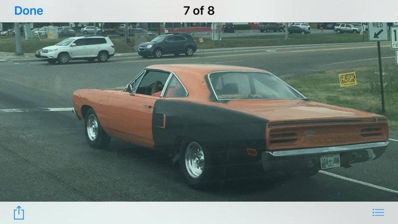

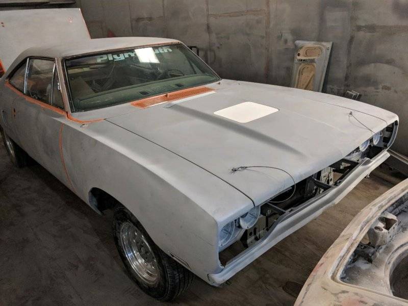

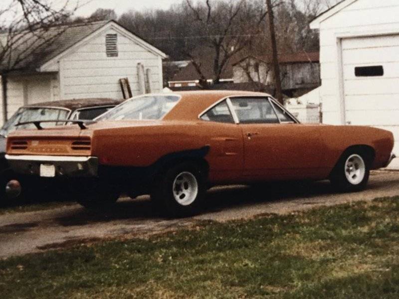

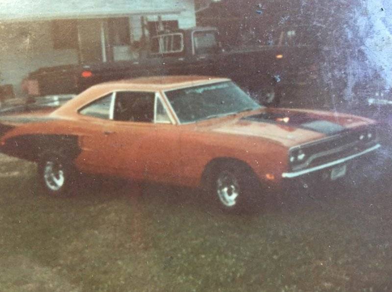

Located the owner of car from 1982 who shared some 110 film pictures of car in the 80's. Notice it has the Plymouth windshield visor still on car when I purchased it.

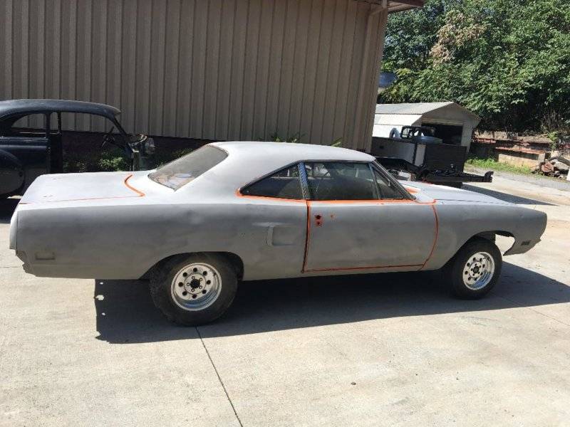

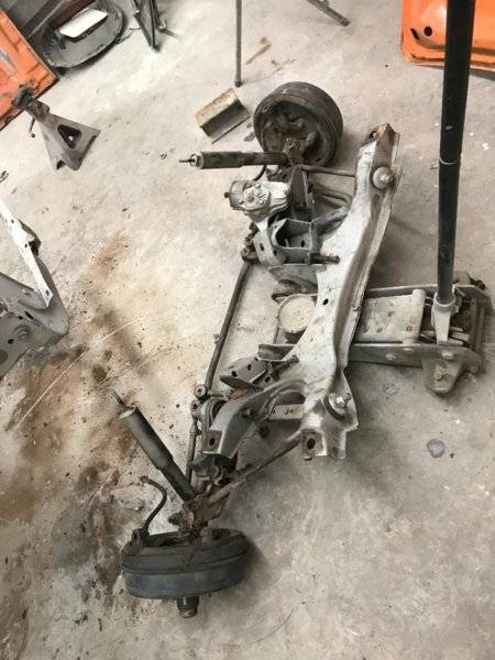

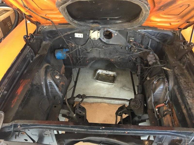

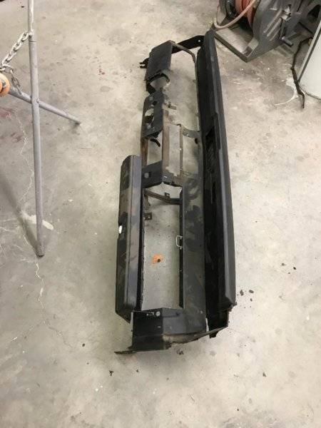

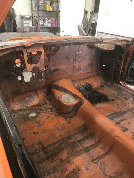

Some progress through Summer 2018. Removed engine, exhaust, gas tank, etc. Degreased engine bay removing the Chevrolet black paint job!!! Stripped all lights, grille, bumpers, door handles, etc and sent to be plastic media blasted.

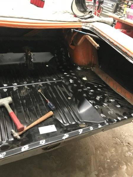

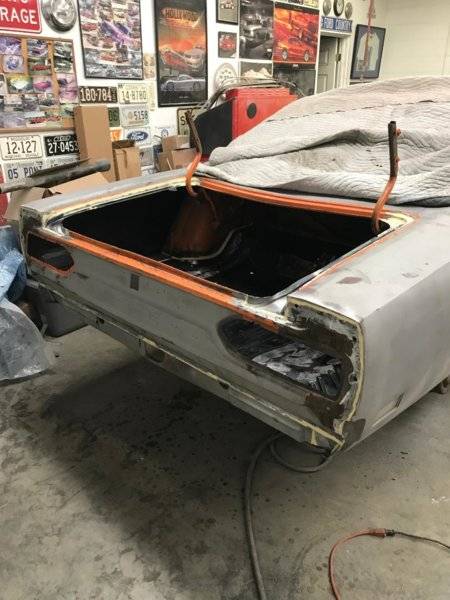

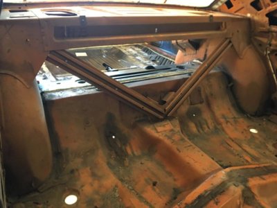

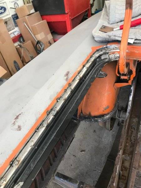

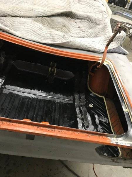

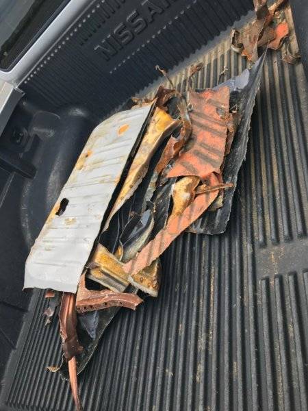

Dropped car off for paint directly from media blaster in October 2018. First thing that had to go was that horrid 2 piece trunk pan. Last picture is of some vintage 1970 scrap.

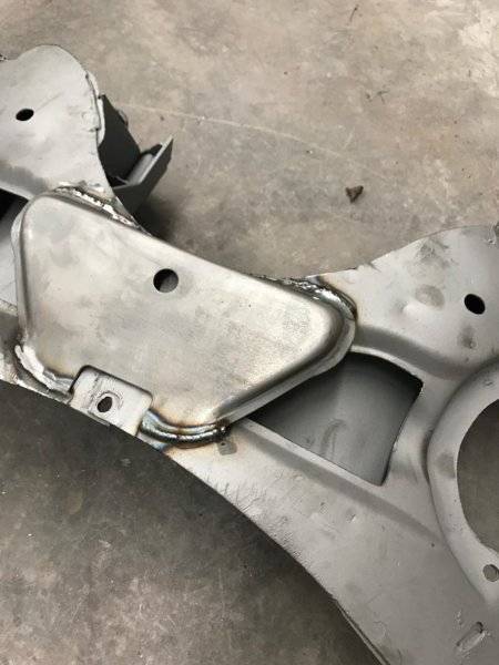

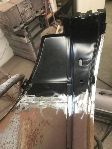

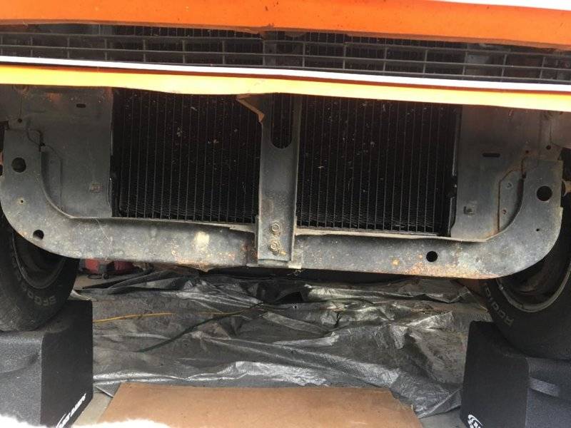

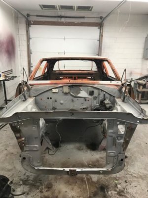

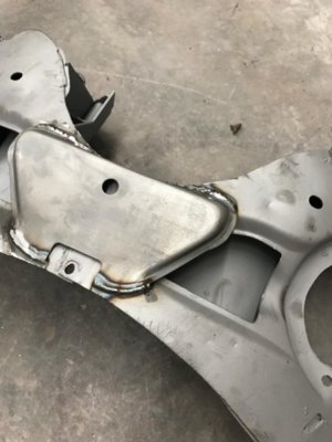

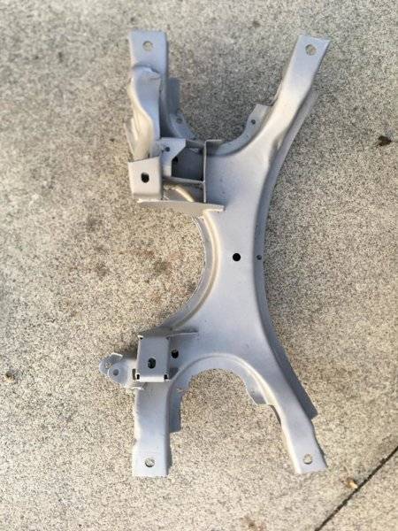

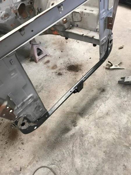

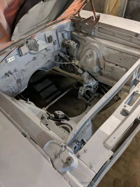

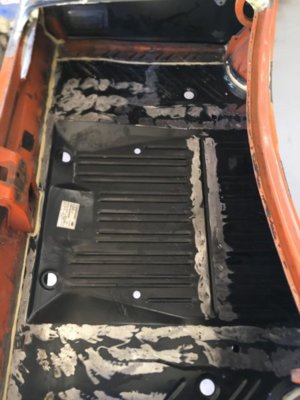

Sometime during its lifetime, somebody killed the K member and bottom of radiator support. Purchased a K member off FBBO and added a skid plate since I am recreating a Six Barrel car. Also more pictures of where we are as of January 2019.
RR47.jpg RR46.jpg RR30.jpg RR44.jpg RR45.jpg RR43.jpg RR28.jpg RR42.jpg RR41.jpg RR35.jpg

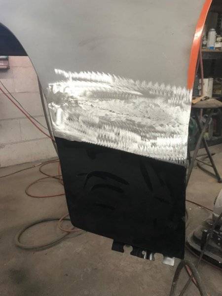

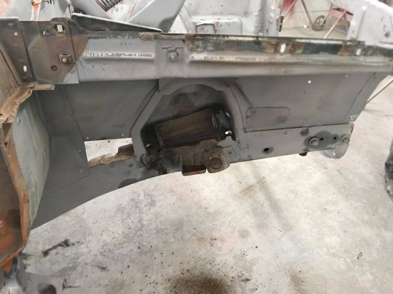

Few more Shop Pics. Replaced lower fender areas on both sides which was the worst rust that remained in car.

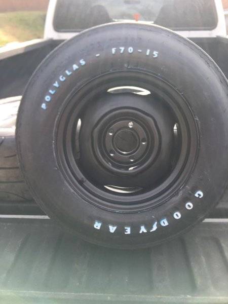

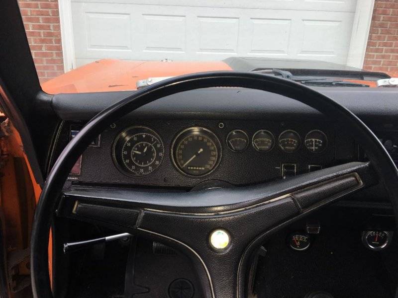

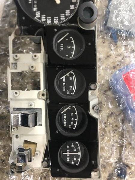

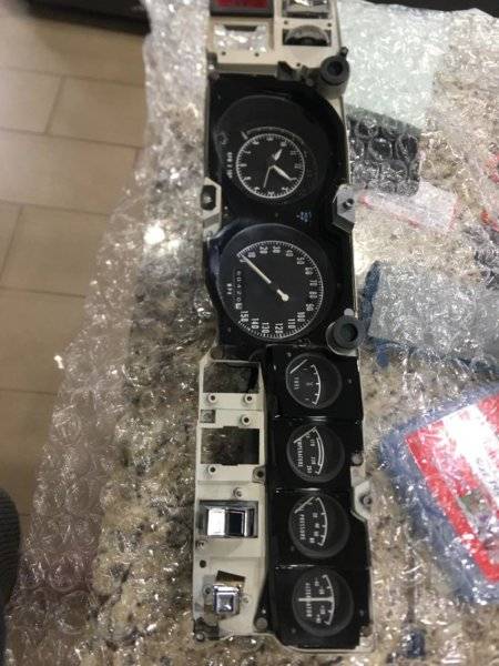

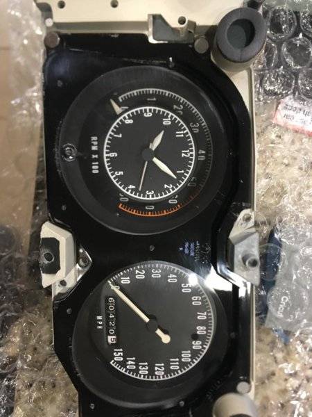

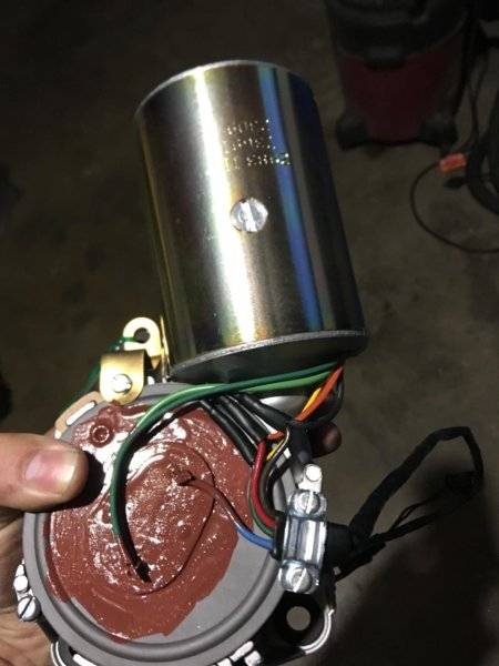

I got my gauges back in December after being gone 15 months. I left the mileage at 60K which is the cars original miles. Also had the wiper motor refurbished and created a vintage spare tire. In the process of painting dash, steering column and polishing my stainless trim.

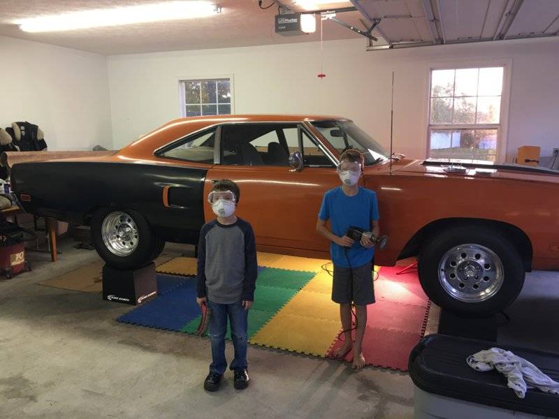

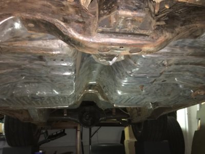

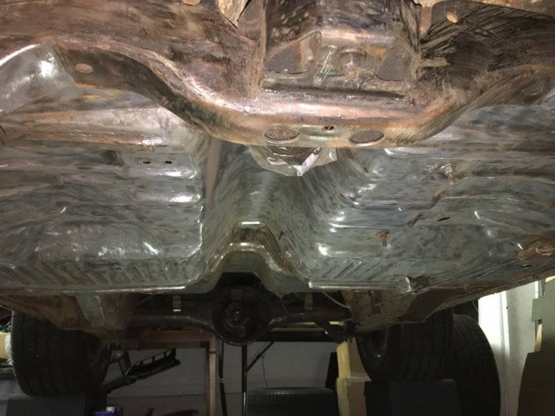

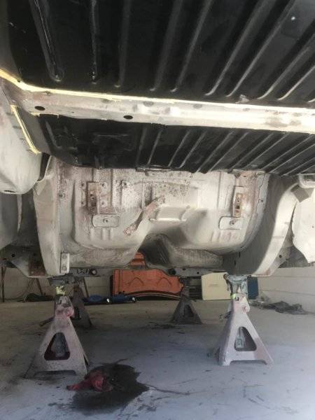

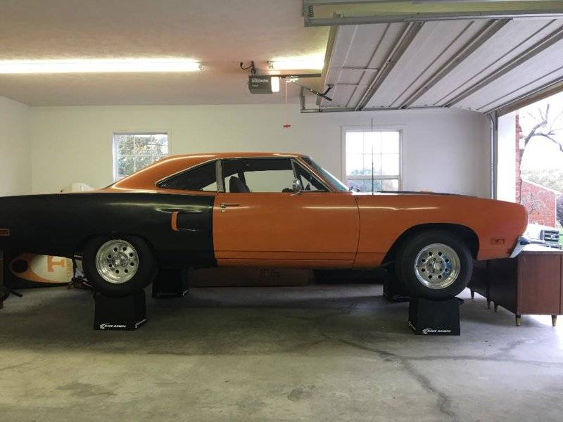

Question - what are those wheel stands under the car (last pic in post #1) and how did you get the car up on them?
They are called Race Ramps. Blocks have handles on them and weigh approx 5 lbs each. The are Concave on the top to rest wheels in and stack nicely when not in use. Best $200 dollars I ever spent. I used a floor jack and 4x4 wooden blocks to lift car under center of rear axle and center of K member, lifting one end at a time. They are rated at 1500 lbs per corner or 6000 lbs total capicity. Also a great & Safe way to introduce your kids to the joys of undercarriage stripping!!! Well safe except for the one in bare feet :screwy:

I am too a Flip-Flop guy, but bare feet an wires off of wheel brushes don't go good together. He plays Baseball and sometimes at the batting cage hits barefooted. He gets that from his Mom :lol: He used drills and cup brushes on a 4" side grinder and cleaned most of the undercarriage before sending to the media blaster. Pretty good job for an 11 year old.
