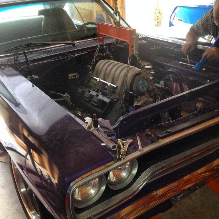

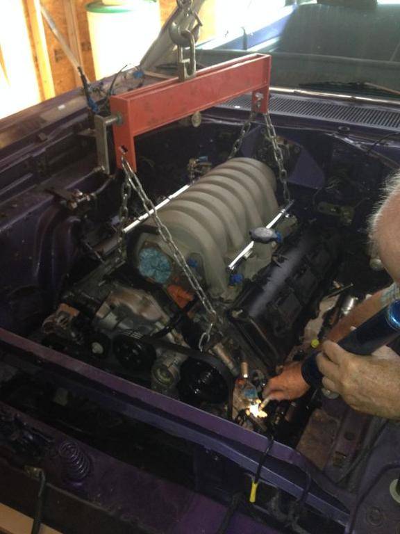

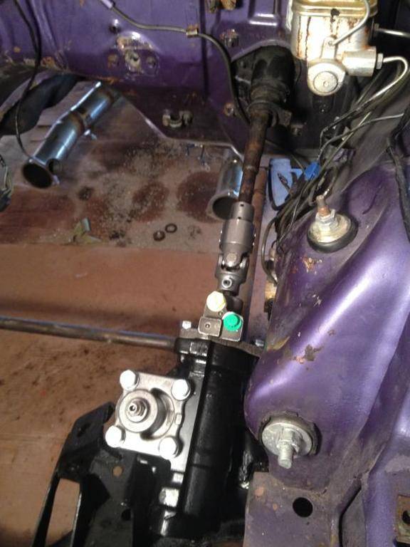

Did a test fit today...looks good...just have to shave a bit off the motor mount/K-frame. Also, installed the Borguson steering box and cut the steering shaft to length. Should have the 727, Turbo action converter, and TTI headers next week for final install.
