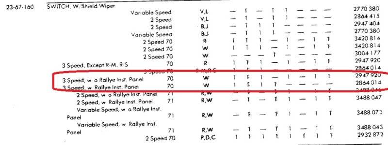

While shopping for a 3-speed switch I am reading in the ads that the repo 3-speed switches and the rebuild ones all say they fit "1970 rally dash". My car has a non-rally dash. So, what is the difference? Can't be electrical. Is it the finish on the switch? Chrome vs Satin. Or is there something about the body of the switch which makes them mount to the specific dash type?

As far as I know the switches are the same fit and function. But I think 1970 had the satin finish. What finish do your other switches have?
I think I am all set now. The rally and non-rally switches are different only in the finish of the switch. Non-rally is satin PN:2947920 and rally is the older chrome one PN: 2864014. I found one on fleabay, so hopefully it will all work out. sucks that I have to pull my dash a part to change the switch........

You can use any of the '68-'70 B body 3sp switches, and '69-'71 C body 3sp switches. Swap the knob (held in with a roll pin) from your 2sp to the 3sp (minor trimming on the inside sides MAY be necessary).
