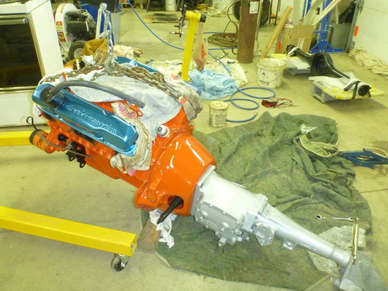

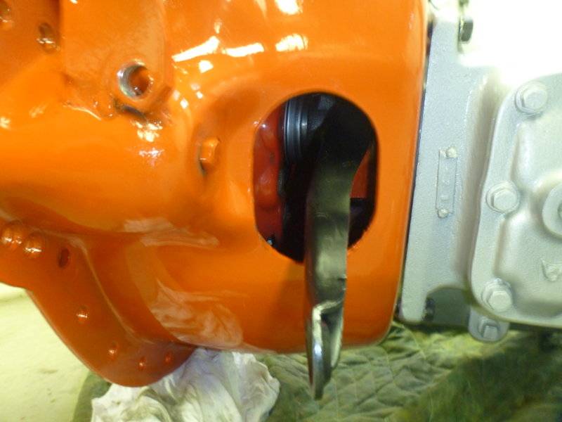

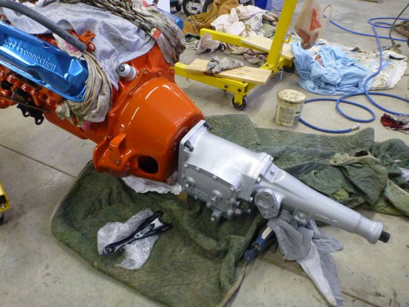

No excuses now.. LOL :D and I did this part of my restoration when I had my left arm in a sling. Takes some tinkering, but you can do it!

Bearing onto input shaft, install transmission and then install the fork.
Dads bee is right, but I don’t know why but this way often doesn’t work for me either. I usually find success to have the bearing clipped onto the fork which is clipped to the bell then I slide the trans through it..
Ps dadsbee, love them blue DC valve covers!
I've done them both ways over the years (40+ of them). A LOT easier with fork in place if you have a stock bellhousing where you can reach in through the lower access to hold or fix the fork hook up. Only way I've ever had luck with a Lakewood inplace is to install the fork after the fact.

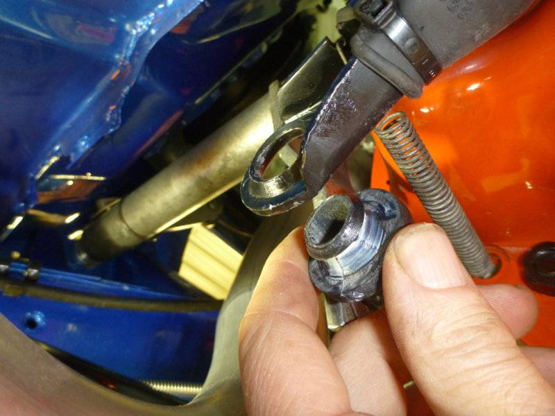

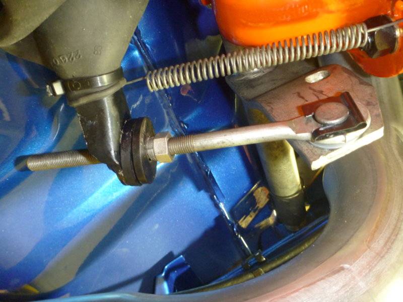

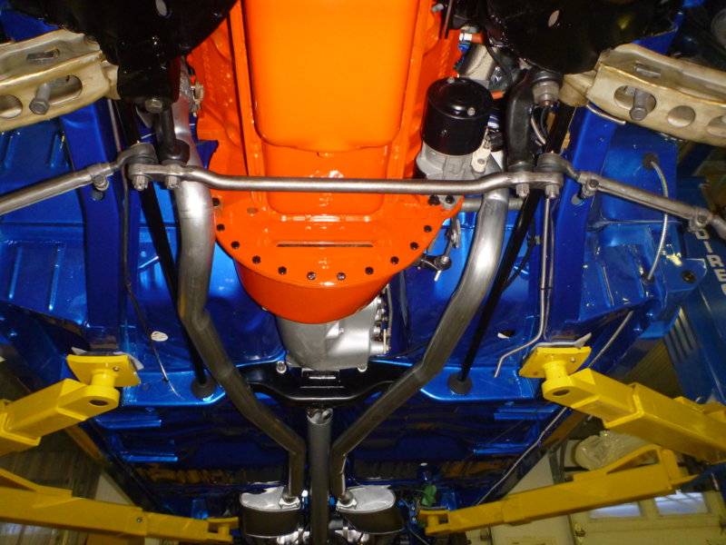

I'm certain I have, more than once as matter of fact when I was a teen (some 40 years ago). Lots of room to do so, at least with stock exhaust... Best I could find for pics showing the clearance available..

Those are great pictures! thank you for sharing! I have a set of long tube TTI headers on my Hemi which i think is where my room to work is limited. its pretty tight. I took a couple day break from it to chill some, it got pretty frustrating hahaha! thanks to all y'all I think I have a new plan to attack it again.
