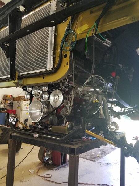

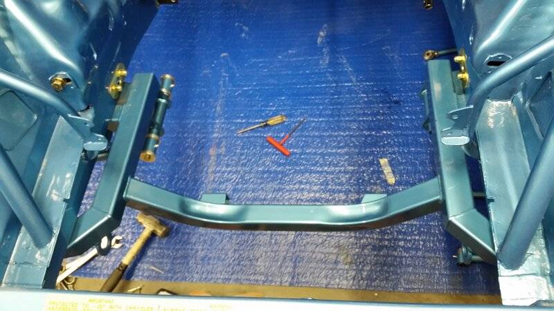

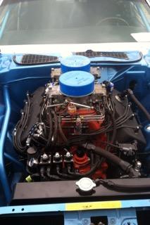

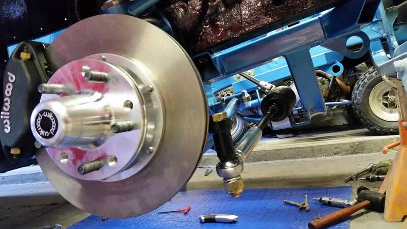

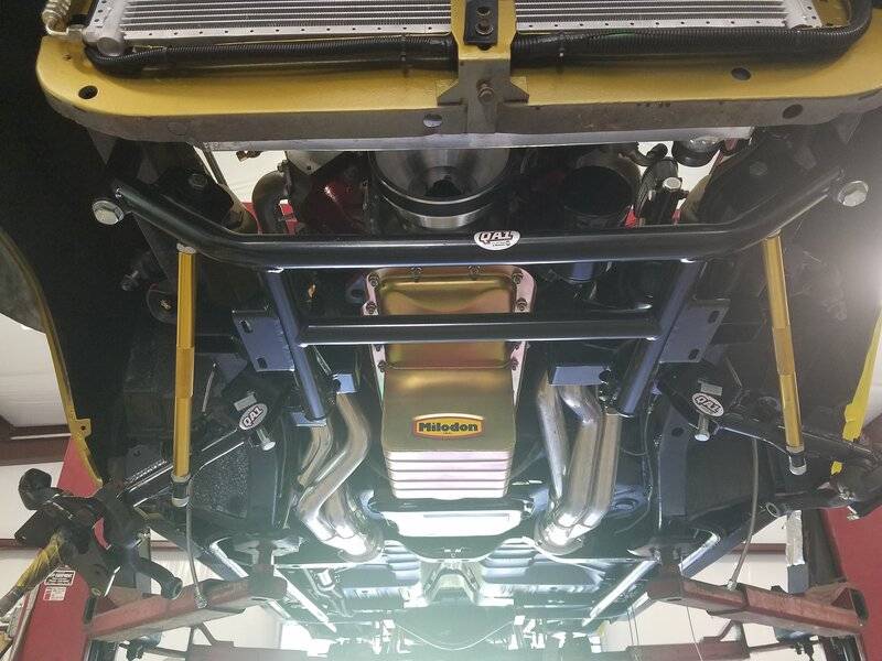

Really like mine on my 67. Perfect fit, and appears to be of good quality.

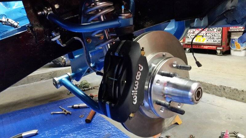

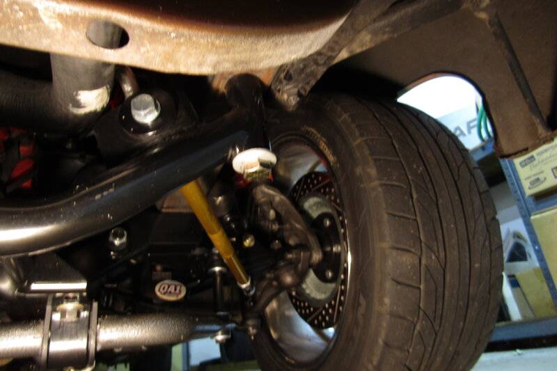

I have the RMS with coil overs in my 70 Challenger. Makes for nice big tube header clearance and I can run a flat bottom top fuel/funny car 10 quart oil pan on the street. It hangs about as low as much deeper trans pan. Both are higher than the headers.
20150920_190437.jpg 20150922_184314 (002).jpg 20150922_184259 (002).jpg rsz_20160414_201144.jpg IMG9539321.jpg
