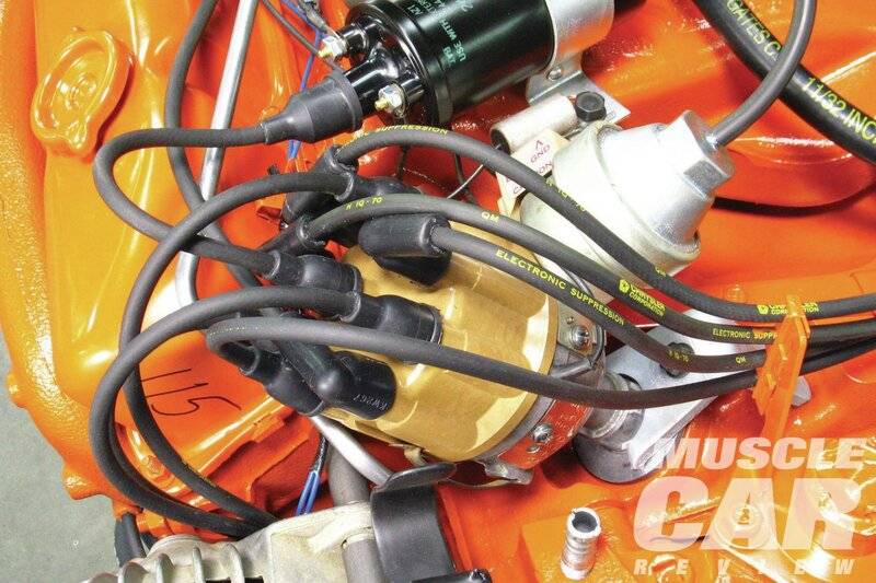

I need to buy new plug wires, distributor cap, rotor + points for my recently acquired car (which I keep finding more things wrong)... For the wires, I don't care about date codes BUT want the correct type and size. Can anyone please provide pictures (right & left side) of OEM plug wires and if they have a 90 degree boot or (7) 90 degree boots + (1) straight angled spark plug connector and what the cable ends at the distributor cap look like?

These will give you PICTURE reference
Factory is 7mm
All 90 Degree boots on spark plug end except # 8 cylinder has like a 135 degree end , not straight
These come with specific directions for each number cylinder and what length / boots etc
https://www.lectriclimited.com/spark-plug-wire-set-215377
Then on Distributor cap orientation looks like this - Straight and 90 Degree depending on cylinder , again stated in directions and that picture is factory correct
If you want everything factory looking without the Chrysler dates you will have to make your own with a universal set
Or maybe Firecore
I don’t know of exact fit like these through another company or aftermarket with exact boots for each cylinder etc
Thanks Bee1971, great stuff! Excellent information and nice pic of the cap too. Until now I did not know that the cap wires were (4) straight and (4) 90 degrees and plugs (7) 90 degree angle and (1) 135 degree angle. I ordered the $60 set (exact look & fit without date codes - I started doing all OEM but keep finding issues and need to reel it in and focus on performance + reliability vs. concourse show trailer queen - I bought this car to drive! ) from Lectric Limited, even learned about the dielectric grease too (had a debate w/ friends last weekend)... BTW the car came w/ "Mopar plug wires but NOT correct...

Instructions give length of wire in inches
and boot angles for each cylinder
And this is in relation to the factory putting the #1 cylinder at around the 5pm position on dist cap like in that picture
Big Blocks counterclockwise Dist rotation
So intermediate shaft and #1 cylinder at TDC on compression stroke and rotor all have to be in perfect harmony
