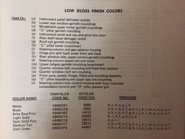

There are 2 basic interior golds for this interior...light gold and dark gold. I got this from my factory body manual. The carpet, steering column, dash housing and dash pad are dark gold. Everything else is basically light gold.

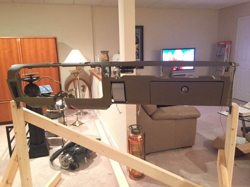

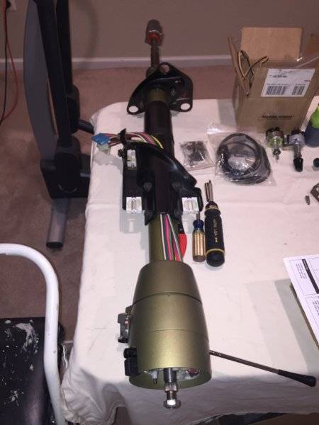

After 3 failed attempts by a popular resto supplier for the dark gold, my friend, who painted the steering column and dash housing parts for me, said he would match the paint. I found a flat piece of original dash color and he scanned it. It took him 3 or 4 attempts but he matched it nearly perfect in my opinion. See the photos. It should have a slight tint of green. He did not use factory lacquer suede paint. I believe he used a base coat and sealed it with matte/satin clear. Plenty good for me.

The dash looks pretty close. And you're right. It does have a tint of olive/green in it, which is original.
