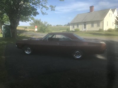

My 72 had 245 50 14 on the front when I got it but on 7" keystones.

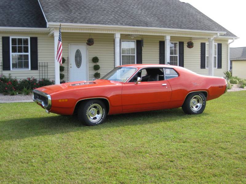

245 and 275's on my 71 Runner.

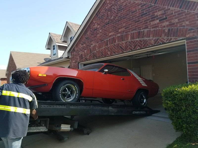

This 245 in the front 265 in the back. I couldnt go 275 because I had to use a small spacer in the back to clear the discs.

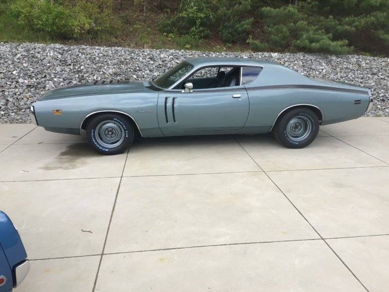

245 front, 295 rear. The diameter is 26.6 on both. It is a lot of tire up front and iif you drive aggressively, they can overpower stock brakes in high speed stops. Cruising is not an issue.
