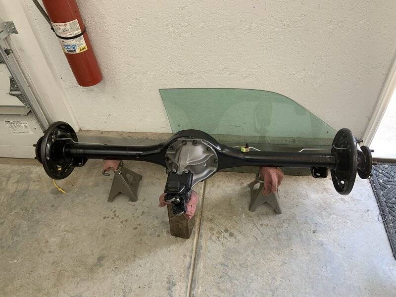

Thanks for the replies, guys. I’ll have to measure my rear end drum to drum width. And the tee block bolt to center of rear end.
IIRC I did have to crank on the "right stuff" trans lines I used to get them to seal.
At least the fittings were larger and more robust on those vs brake fittings.
They were also bent differently than OEM, which I thought was odd considering the company name (although they were easier to install because of it).
Dr Diff states on his website to measure the overall width of the rear axle drum to drum.
Is it from outermost edge to outermost edge of the drum?
Is it from base of brake line fitting to base of brake line fitting on each drum?
Is it from outermost edge of hub to hub?
So far, I am not coming up with any measurement that comes within 1/8” of any of the 5 measurements he is asking me to select on his website. I’m 99% sure this is a factory width 8.75” rear that has not been narrowed.
I’m asking on here, because I have the *** end of the car up in the air now, and Dr Diff cannot be contacted today.
This is the order I placed when I did my 71 rear axle.
Rear Axle Brake Line Selector
Options: Model Year: 1971; Platform: B-Body; Model: Charger; Rear End: 8 3/4"; Rear End Width: 57 1 /2"; Vent Bolt Location: 11 1/4" from Center of Housing; Rear Brakes: Drum; Choose Brake Line Material: Original Material (+$30.00); Add Rearend to Body Flex Hose: Rubber (screw-in type) (+$20.00); Add Brass Tee: No; Add Vent-Bolt: No;
