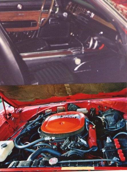

I need some help from you wise old owls on this one. I am OK with modifying but is it possible?
Yes, it has been done many times. If you are using a stock compressor the AC base has to be notched to clear. You might think about using a smaller AC compressor and you might get lucky or not have to notch as much.
Yes, mine has been notched and on my Charger since I was 19. Almost 33 years now.
Many thanks guys!
