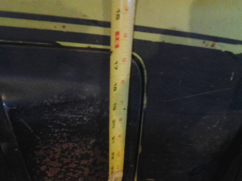

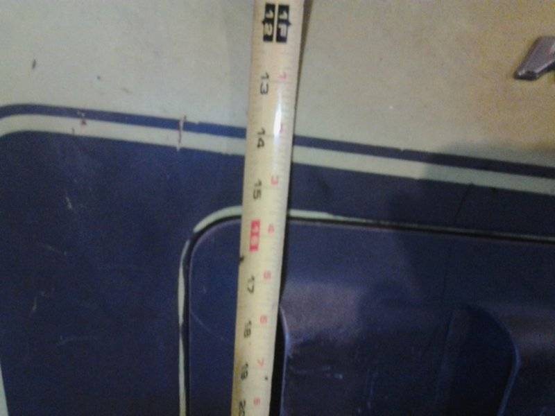

I measured from the center of the back edge of the hood, the recess for the louver is twenty inches to 42 1/2 inches. From the side the rear edge of the recess before the corner is15 5/8 inches and on the front edge of the recess it is 16 3/8 inches. It is the same on both sides.
Your best bet is to make a poster board template of the insert, and use the measurements I gave you. Measure several times before cutting the hood.

Thank You very much for the measurements of the insert location! The cardboard is a great idea too!
