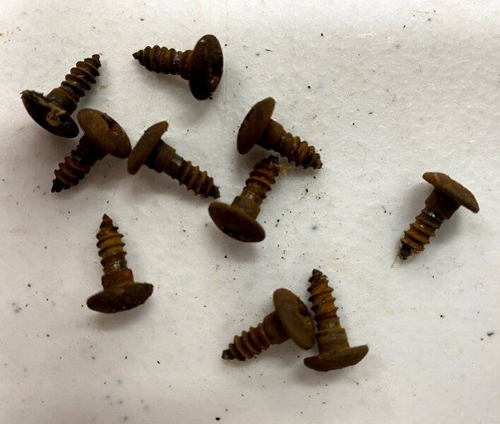

I found some 1971 E Body cowl vent screws , and they are black phosphate 1/4" nut driver type head screws ?
My 71 b body mid to late prod. has tabs
The E-body ones are kinda close but the originals have a flat head. Here are the originals on my 71 SE Late August build. I recently parted out a early January car with the same screws. Both Lynch Rd cars.
