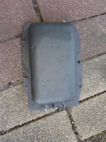

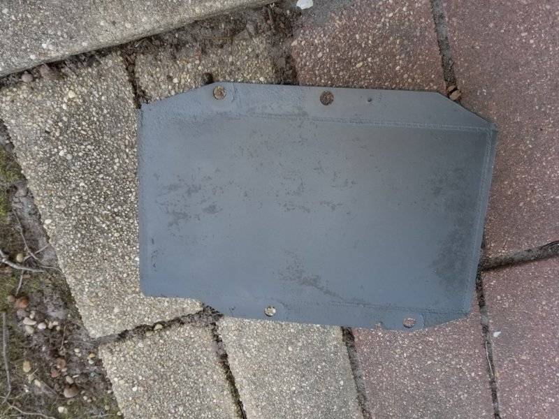

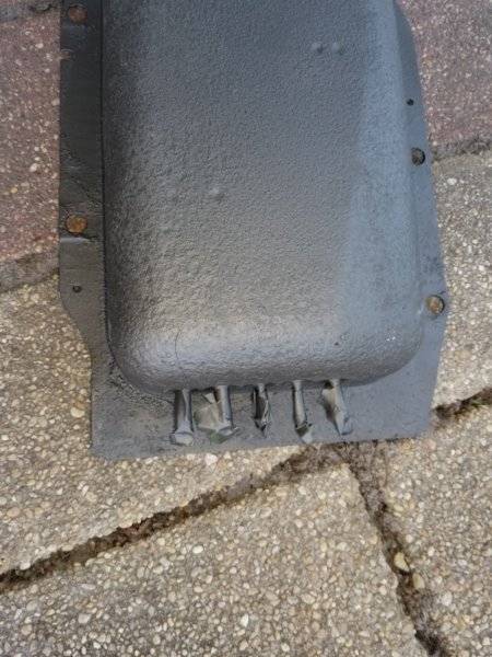

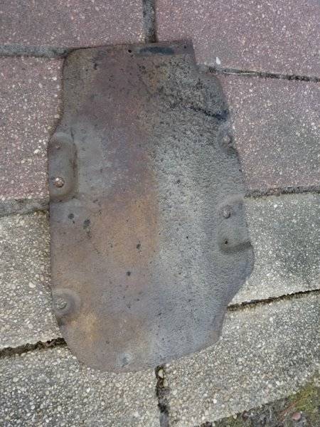

on 71's they have a vapor recovery tank that is located in the drivers side wheel well
the tank hides behind a cover
if you need those parts, I have them
that is where your extra lines go to

This is a mechanical fuel pump with 2 connections on it one to the carb and one inlet from the fuel tank, going to get a pressure tester seeing I've been borrowing one for a few days I had to give back. Let you guys know what pressure it is at. I do not have the vapor recovery tank or any other components. Cant seem to find this component on any sites, can you send a picture? This car was just the shell and motor and ive been piecing it together. Seems like I will start with pressure test and disassembly of the top of the carb possible for the needle to get stuck. Thanks guys Ill let yall know results soon

https://www.forbbodiesonly.com/moparforum/threads/fuel-vapor-recovery-tank.62162/
71 satellite vapor tank
