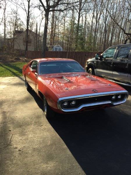

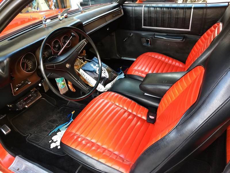

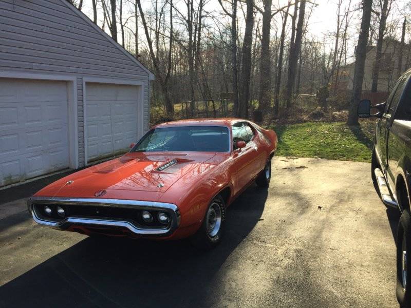

Wow, thanks for the feedback. I didn’t know what to expect with my post but am encouraged. My 71 roadrunner was born with a 340, but the original owner changed it out with a ‘71 383. I’m not looking to race or run it hard often, rather a weekend driver, local shows etc. I need to do some work to the interior and am currently dealing with some rust on the frame so I’m not looking to put a huge amount in the engine as I it has other needs. That said I can see putting about $2000 to improve the engine. I attached a few pictures to this post.
