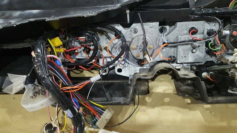

Like this?

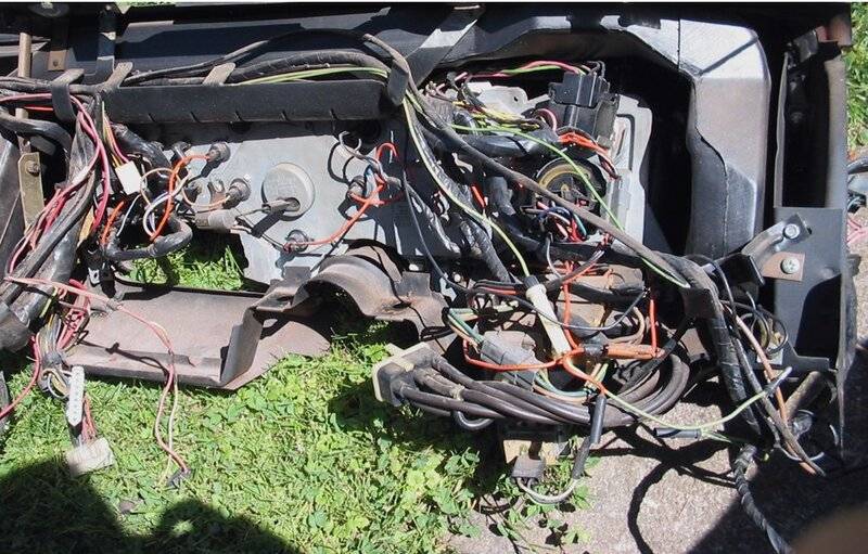

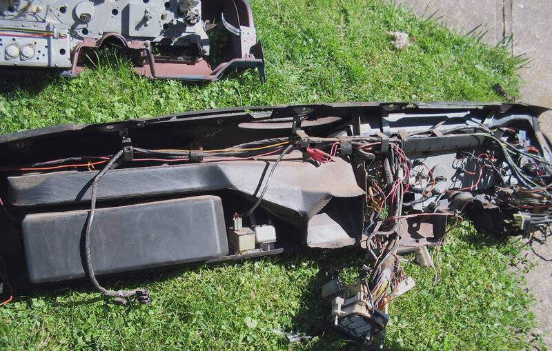

I think most of the pics available around are, for whatever reason, for rallye cluster and I guess your Satellite is standard cluster ? or is it a SSP or Brougham ?
Sure not all cars got same options, so you'll find on this some relays not optioned on your car ( it came from 71 R/T with conc headlights )

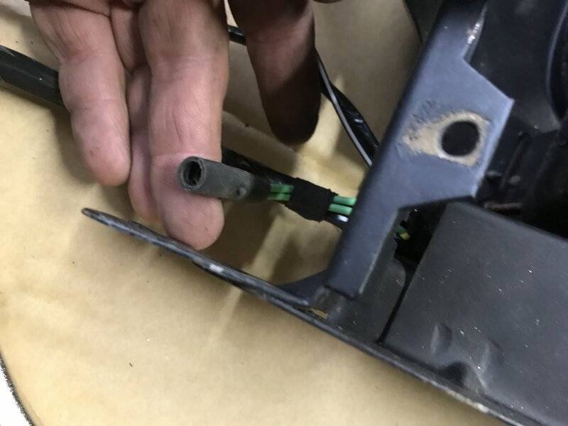

Is that a Rally dash? I guess it doesn't really matter as I just needed the routing information. Thanks guys. I have 2 wires on the dash harness I have no idea what they are for. One is on the driver side its a green with black tracer and a single I think female connector. The other is on the left of the cluster and is also a green wire. Oh yea almost forgot 2 blue wires that come near the lower section. I assume for AC this was an AC car but doesnt have the under the hood stuff to make it work. I cant find a place to plug those into.
Depending on options and such, either you use those wires or have to take from old and add to them. What you don't use or need, tuck them away. A new harness won't have every option that cam from factory so some wires has to be transferred.

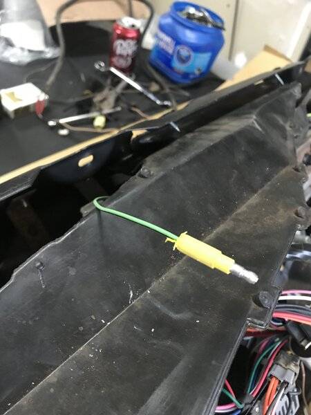

Light Green wire with bullet female end could be the source for Charger concelead headlights which Plymouths won't use of course. But harness is the same for both. Is the same even for 4 doors
Now, green with a black trace... can't recall any green wire being black traced around.
You can get blue wires hanging around to source accesories from run circuit, such electric trunk lid and stuff, or even headlight concelead system. Everything will be hooked up or not depending on car options. If not used will be simply hanging around without use
Yes, pictures are to Rallye dash. Standard dash is pretty much the same but one round multipin conector instead sockets and terminals all around to individually feed every gauge.
Accesories as tach, A/C or heater, concelead lights, power windows and stuff like that gets their own harness and they are not included on underdash harness not even from factory. In the Heater- A/C harness example, the underdash harness just gets the black wire ( I think traced white? ) with a naked packard terminal without any isolation hanging around which will feed the blower but to be inserted on the A/C or Heater Harness plug which must be transferred from your old harness. Or get the harness separatelly new if available.

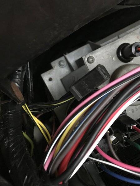

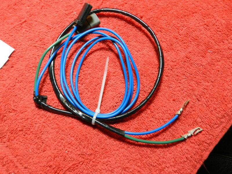

1st pic, AC wires. Green blower, blue clutch. It runs to bulkhead. Just at a side of a white and white with black trace wire, on the NSS harness section of bulkhead. Those wires inserts there. Can't recall which one on which cavity thought. I have diagrams but is late here to check my PC. Will tell you tomorrow.
2nd pic, lights on warning buzzer plug. When optioned, that plugs gets an extra harness to reach the buzzer.

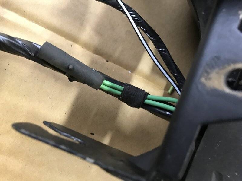

3rd pic, that's an accesories source. Noticing you have AC harness, that must be the terminal to the clutch being feeded. Underdash harness got a yellow rubber mold with three female provisions with a tan wire hanging around, close to brakes pedal area. That wire conects there

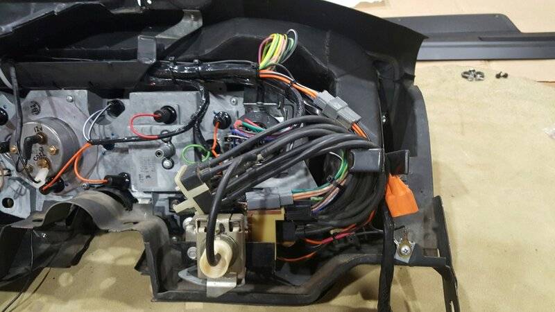

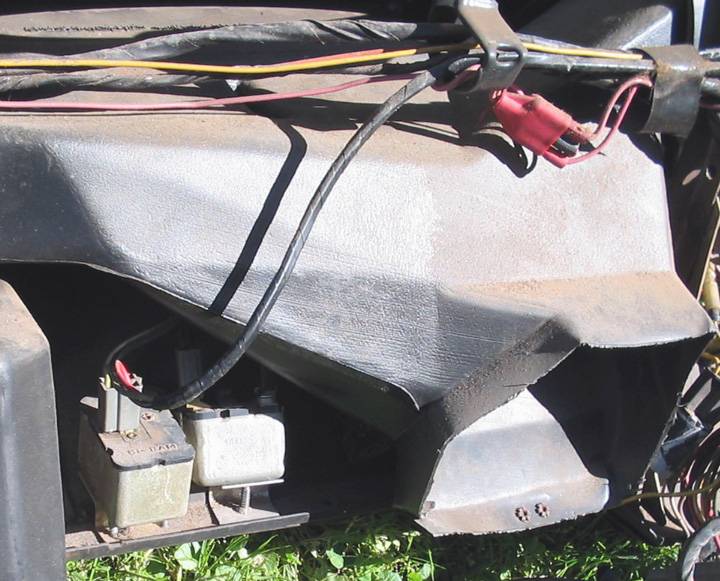

4th and 5th, is the headlights wiring and that's the plug to trigger the hideaways on Chargers.

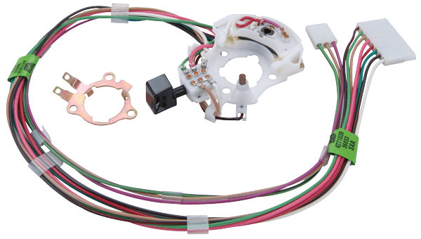

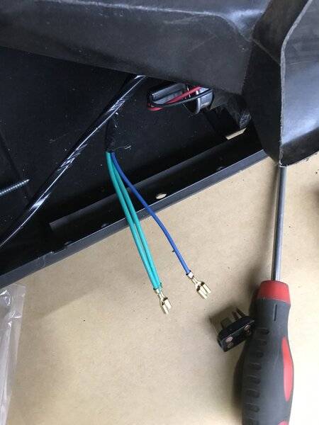

Awesome thanks very much. You have me sorted out now. There is a 3 wire plug that comes out of the steering column and I have nothing to plug that into. Any idea what thats for? The schematics do not show this. I thought it might have been for cruise control but the column is sort of plain. Nothing special about it. The wire colors are more of a pastel color set. I'll get a picture of it.
Did you replaced the turning switch someday in the past? MaMopar at certain moment began to offer one only turning switch to all models and making the stock easier for all cars. C bodies used the same turning switch and some C bodies got cornering lights. An extra pigtail from turning switch was used for this, usually carrying Violet, tan and light green wires. This pigtail was used for that function. You won't be using that plug.
Wow.. That's the one I'm talking about. It's not my car I have no history on the car so I'm not sure if the column is original or not.

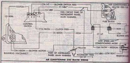

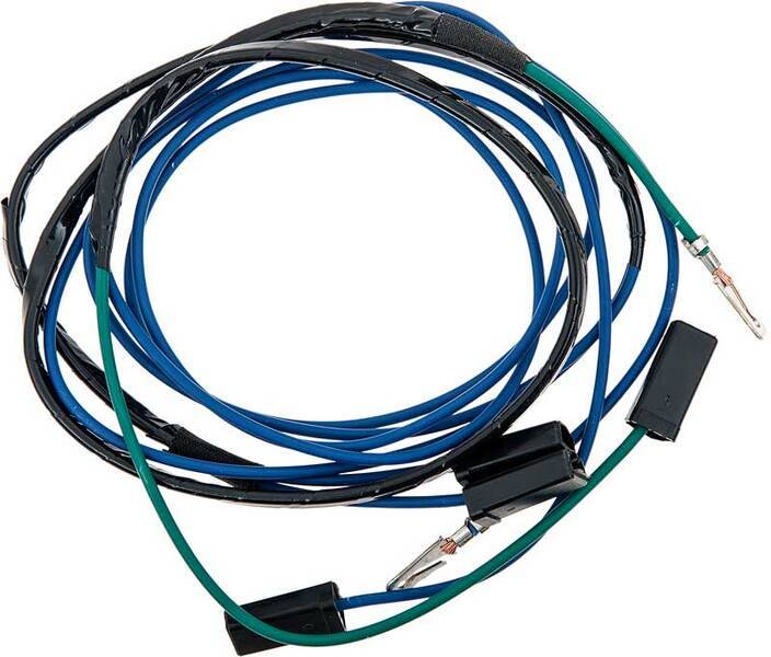

this is the location for the A/C harness into a 71 bulkhead. There is also the solitaire male bullet plug and where conects on underdash harness. You only have to find the Acc feed ( yellow molded source with tan wire ), which should be leaving the tape on the main big bulk section of the harness... close to the brake pedal brakets area as far I recall

I have another question Im a little confused. On the Blower motor wiring. There are 2 wires on the blower motor. One is a ground bolted to the wiper motor and the other has a single plug. I looked at your schematic above and its just not clear to me. Where does that wire go to? would it be the number 4 terminal on the bulkhead connector? And on the inside of the car would I use that double green shown here for that?
I went back and re-read your post. I think I got it. Yes the Green with that blue is the blower wire. I need to stab them both into the bulkhead and use the green one for the blower feed. Got it.. Sorry I didn't re-read that post.
:thumbsup:
having the A/C harness on engine bay side, they use the same NSS harness plug to be attached, then the blue and the green runs to each destiny. Green straight to blower and blue to the Dryer pressostatic switch sensor... then to clutch
( althought this harness on pic doesn't show the dryer switch to clucth wire section )
