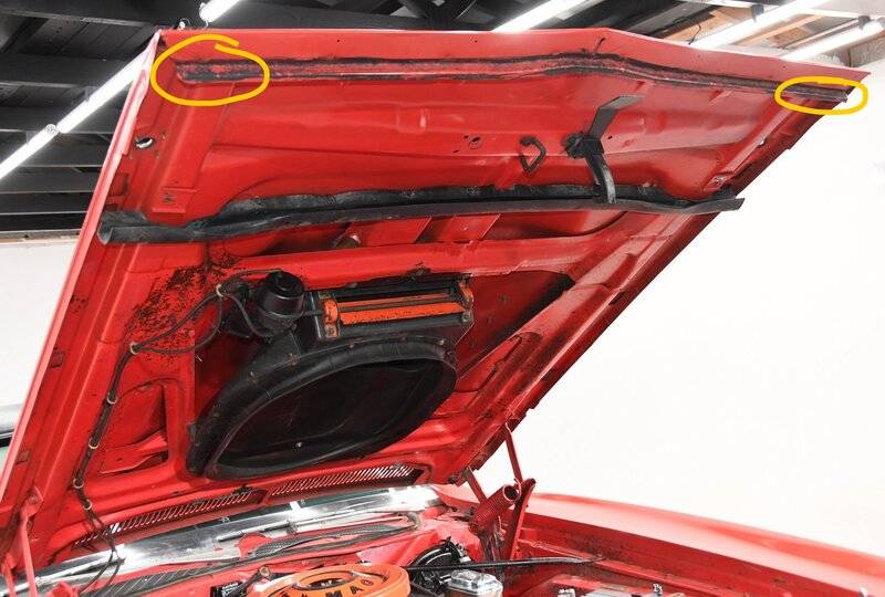

The 71/74 Charger hoods are interchangeable EXCEPT for one detail. The front edge of the hood on 71/72 what hiddes vertically behind the bumper ( which works as a filler ) is a bit longer than 73/74. 73/74 were made shorter to accept the fender to bumper top brace which on 73/74 is a bit bigger. So if you get a Ram hood ( or any other 71/72 hood ) to install on a 73/74 will need to trim out a bit this vertical edge or filler.
Dunno how call this section of the hood... vertical edge... filler...
71/72 and 73/74 Plymouth can still bolt on and close.
Minor body line difference between the two designs.
