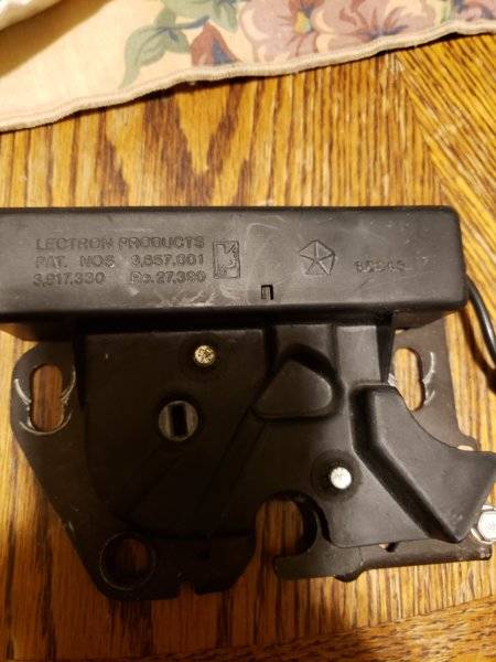

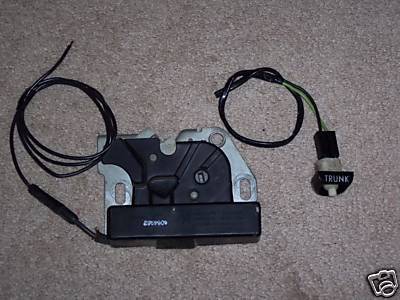

I'm piecing together an original electric deck lid release on my 72 Charger. I sourced everything but the switch. Does anyone know where to find one or a picture of it?

As far I know, was an option on 4 doors sedans, not really on 2 doors. I tried to find info about the button location and look and couldn't find the info. I retrofitted the lates 70s and 80s units anyway on my 74.
Here a setup but bezel to be fit horizontally I guess down the dash Or maybe on top of the glove box liner. The one I found says OPEN REAR to be installed vertically ( which I likes more )

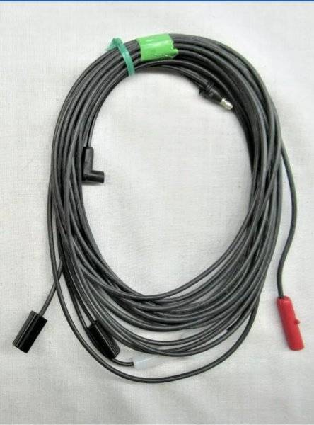

Here ya go.

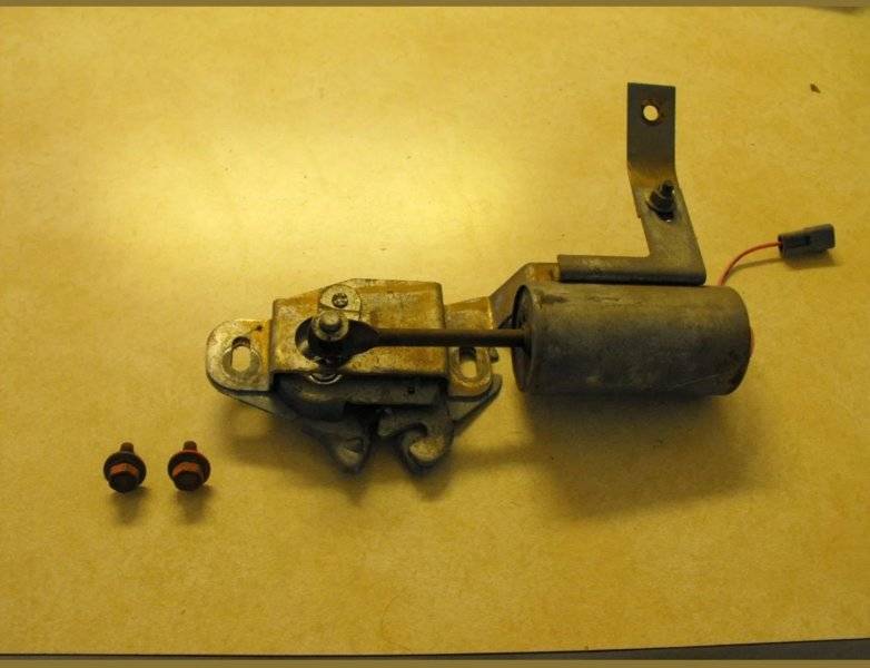

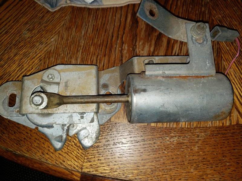

68/70 trunk release system were vacuum operated.
and about the correct trunk release button for 71/74. Never have seen actually one BUT the one you shown with the TRUNK bezel looks definitely diff than the one I shown on the pics

Im not sure what year that came from. I got it of Ebay last year for my 70 Coronet. Haven't gotten around to installing it yet.

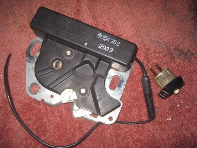

This one has a regular single plug. The switch end seems to take a bullet connector. Which I haven't been able come up with. I seen a 73 and 74 switch but it is a spade connector not bullet. So I'm kinda pissing in the wind at this point. Lol. I appreciate all your input truly. Just thought someone out there has one or seen one before.
This is exactly the same setup I have ( open rear bezel ). You can see the two prongs. The trunk bezel is exactly the same switch, just diff bezel for a diff location. But I can't say is the correct one for 71/74.
When searching on web found somebody selling a NOS switch, but without bezel. Can't find it now!

Thought I would offer up what I ended up doing.
I clipped off the bullet connector that ran to the trunk latch and put the proper spade connector.
I ended up mounting the switch inside the glove box. It works great!

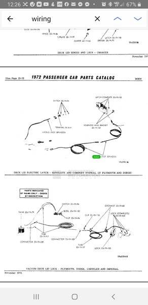

And I did concur that this is in fact a factory trunk release correct for 72. I did so by FSM and 72 parts book.
