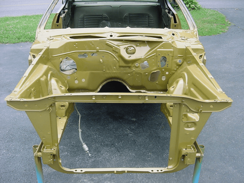

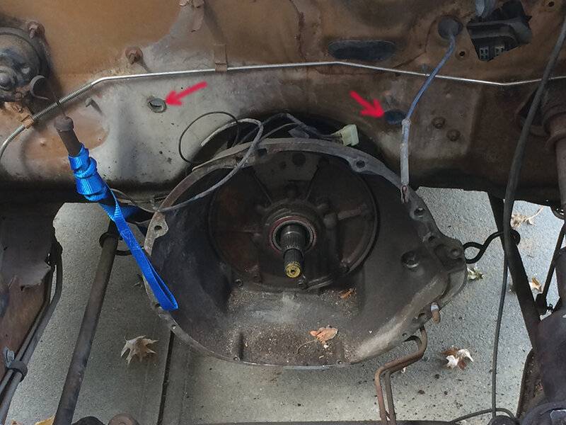

Starting to repair the firewall on my 72 Charger. The holes marked do not look factory, they are not round and jagged. Ok to weld them up?
Not factory... Here is my 71 Plymouth a/c car..
Just for kicks , do the holes happen to line up with the freeze plug in back of the head? If so thats the way line mechanics replaced them. Saving the customer $s and saving you from having to pull the heads.
Thanks guys!! and no they dont line up. They are at different heights. Some butcher mechanic needed a shortcut.
That is so correct. I actually did that on my 69 Roadrunner in the middle of winter. My freeze plug on the back of the head was leaking. I judged where it was and drove a screw driver through the firewall. Opened it up enough to replace the plug. Sealed the hole. Hay in 1973 I did not have a job or money to fix it correctly. Thanks for jogging my memory.
