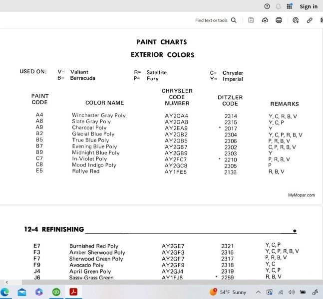

Here is what I found from a '71 Ply Body Manual
KB5 leans to turquoise.
