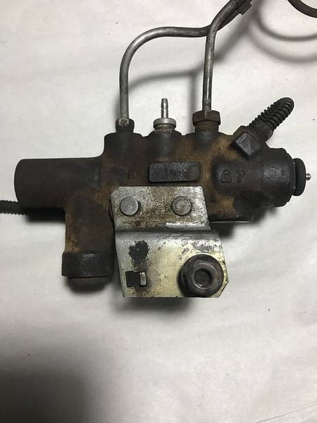

Anybody still running their original cast iron disc brake proportioning valve. I am thinking about getting mine professionally restored unless someone has other recommendations.
I recently rebuilt the one on my 73. Pretty easy to do. Worked great when done.
Paul_G did you use a kit from Nacho-RT74 suggestion of muscle car research and if so which one did you use? There are several listed for the iron valves.
I did use the muscle car research kit. There instructions online are very good. They didn't have exactly the right one for my 73. But the kit had most of what I needed. I'll get the part number later today.
Nowdays the kit is more complete than when I got it. Althought I still haven't used it on my dist block because my car is STILL in pieces. It seems now the parts for the front section of the block are available. when I got it just the differential pistons O rings and the prop valve section were available.
It's nice all this O rings are available now as a kit, but actually you could allways get those O-rings in the past, just they are in an special Rubber able to support the brake fluid. Not any kind of rubber is able to live on brake fluid. Having them on a kit you don't need to guess anymore which one you really need.
I decided to send it out. It will be sleeved and restored by a place in VA. They did my master cylinder.
