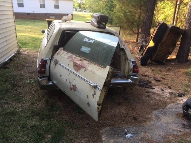

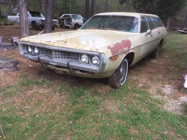

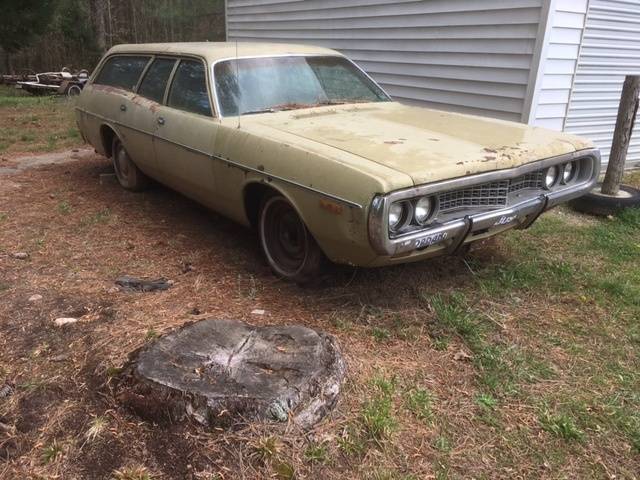

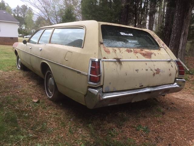

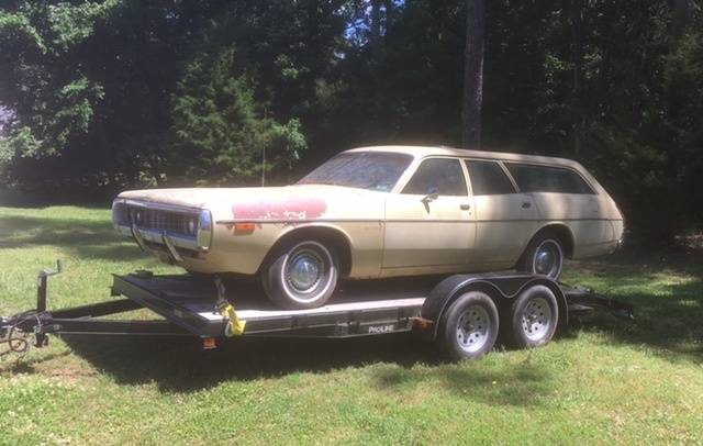

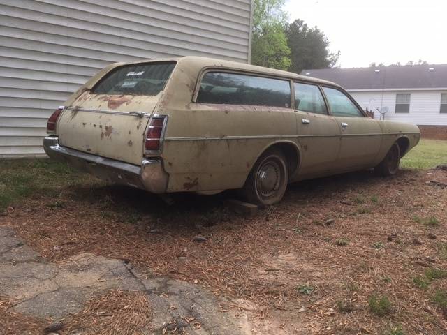

This car is being built to be a street/strip/car show/cruiser type car. It is for sale as work is being done. I bought it a year & a half ago. I've been slowly but steadily collecting parts for it. It won't be a Barrett-Jackson quality car, but hopefully a nice enjoyable non budget buster. First pics are when I picker her up in Greer, SC & when I got her home. Nov 2015

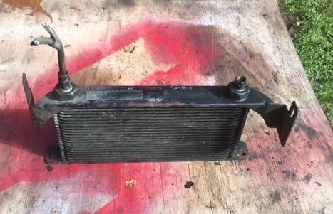

Some of the parts I've collected. Not shown is a 8.75 rear sourced from ne of the 68 Plymouth Furys I parted & a 440 engine from a cop car.

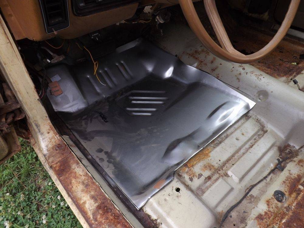

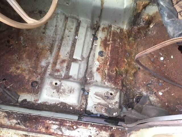

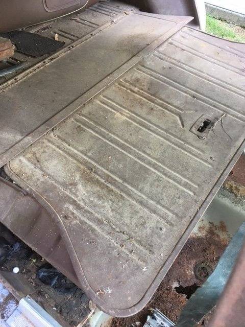

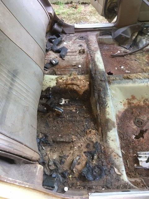

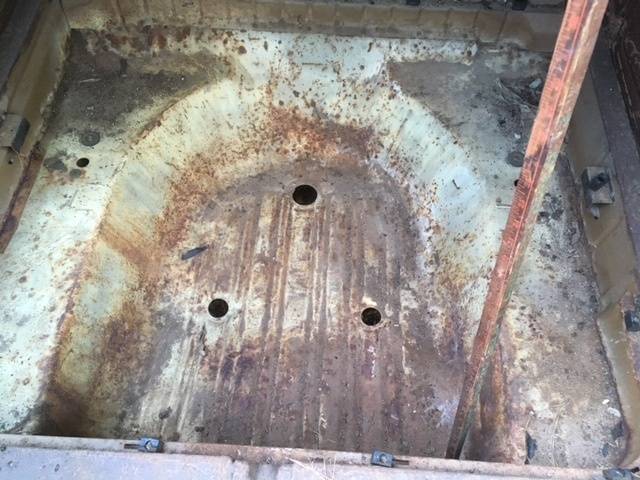

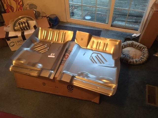

New front floor pans from Year One. I called them & they said they where the same for the wagon. No one makes pans for the rear so the resto shop is going to fab some from a C body car he has been using for parts

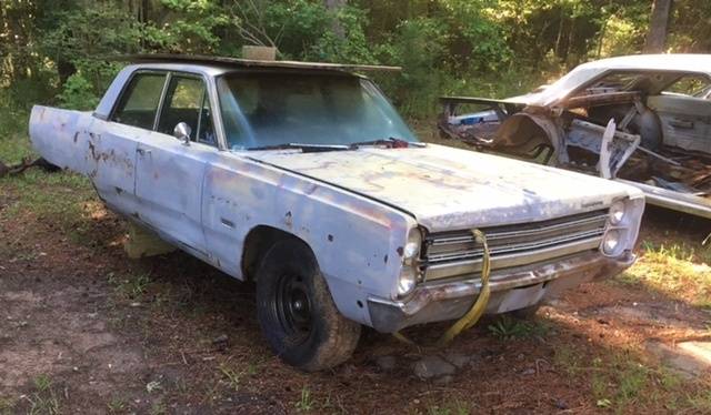

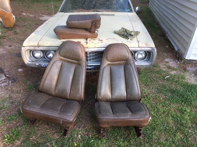

This car will give up is Magnum 500 wheels to the wagon project. This 68 Fury is for sale. I haven decided if I want to fix or part this one yet. I'd love to fix it just too much going on. And it needs a lot. I have a parts car for it also

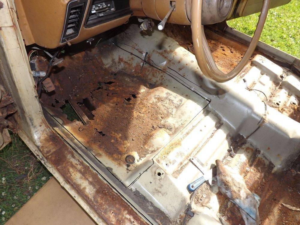

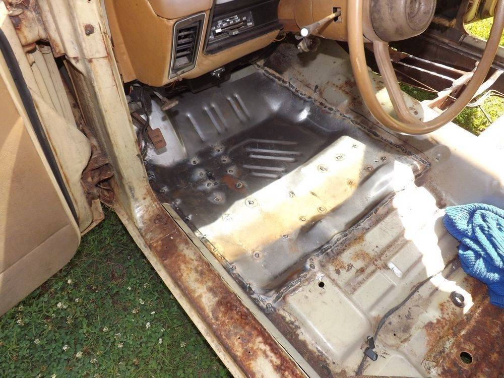

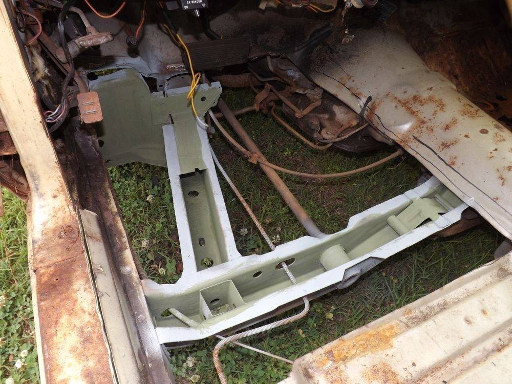

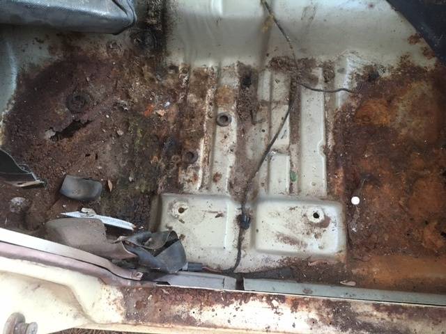

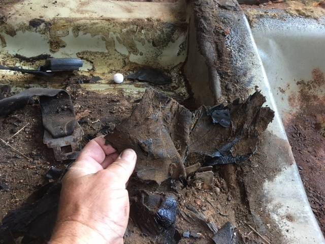

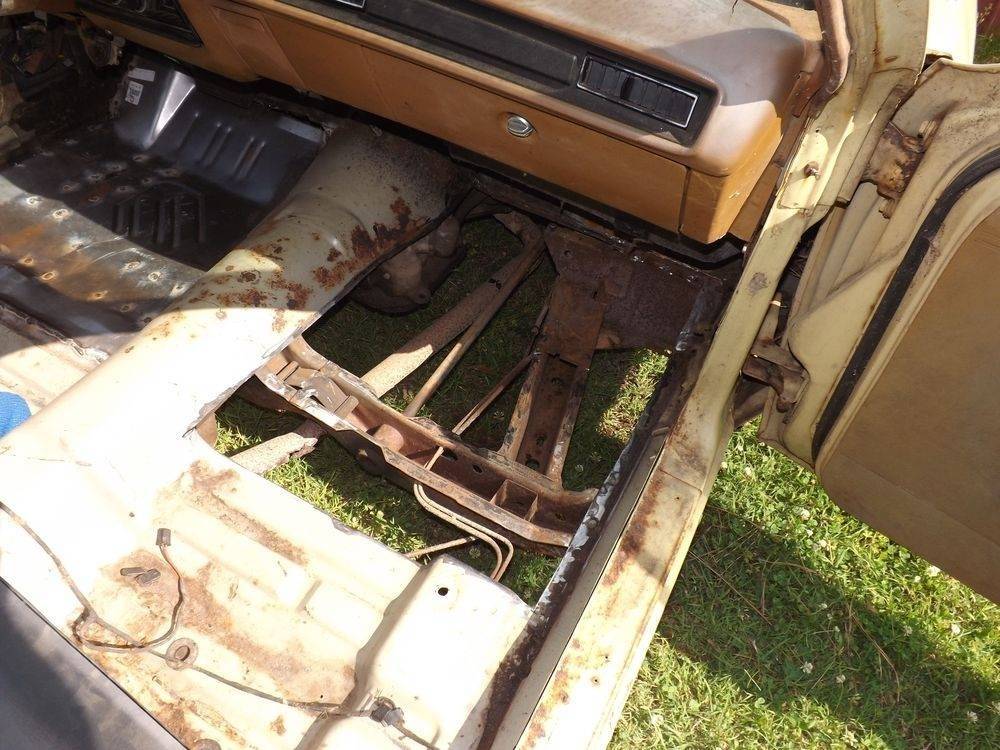

Work began on May 22 as planed. Old drivers pan removed. A rust preventive coating applied & weld through primer applied. New pan welded in place

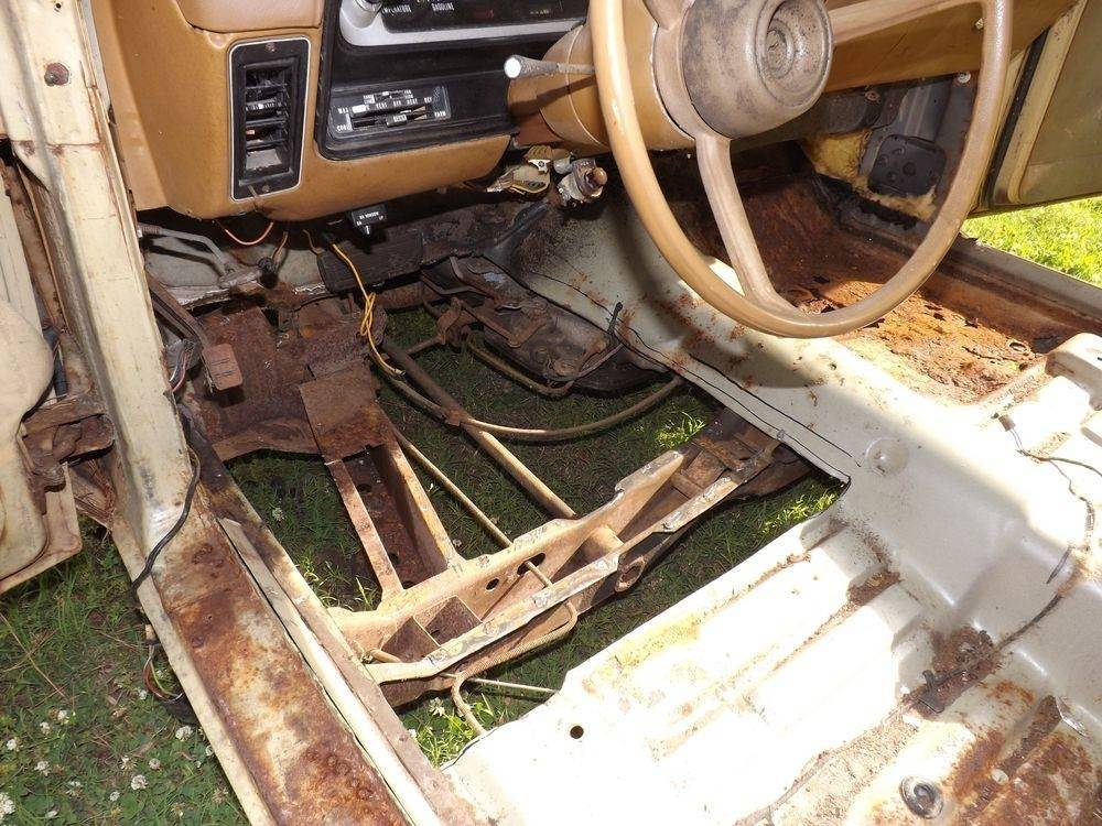

He's having to work on it outside the shop as his shop was full if old cars. Mostly old C body cars. He does very nice work. He cut the passenger side pan out yesterday May 25th. Very pleased with the work & time

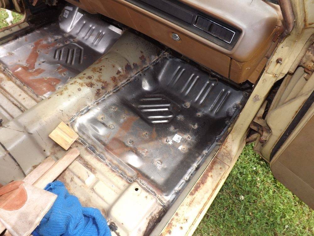

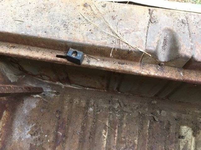

The passenger floor was welded in today. And he got a patch for a bad spot in the pass rear door jamb.

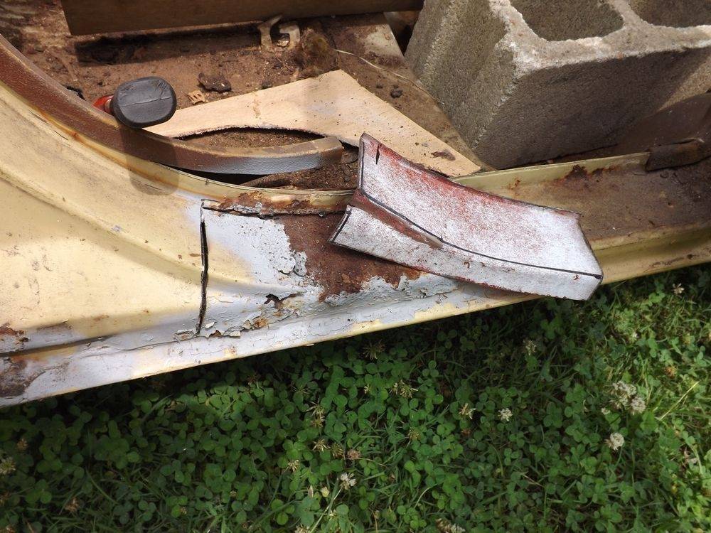

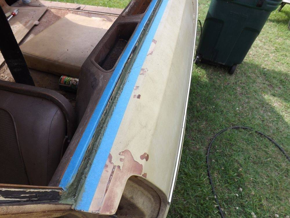

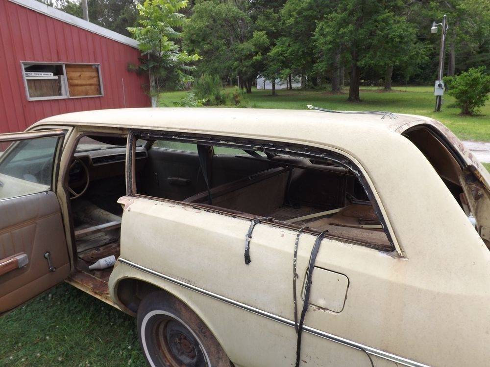

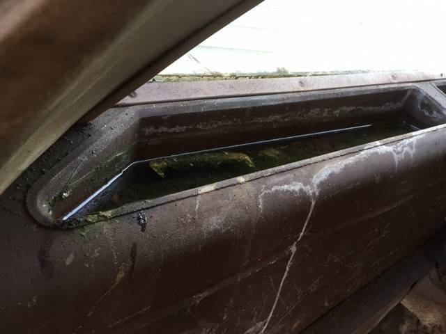

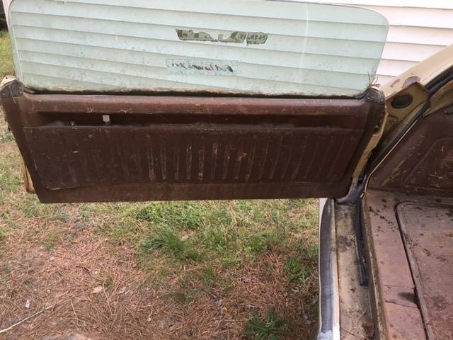

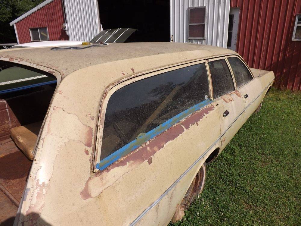

While waiting on some rear floor pans Gary started on the rear side glass. The driver side was leaking bad, but was caught in time & only surface rust in the channel. He cleaned & primed it. Also the pass side was showing some signs it too was leaking so he is going address that too.
