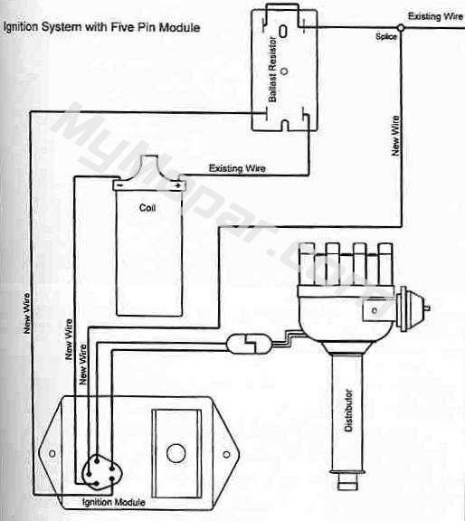

this is the best Year One sells a engine bay kit from M&H Electrical
unfortunately only sold exclusively thru Year One

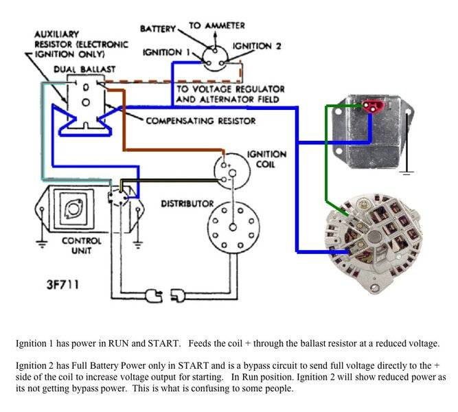

Chrysler Electronic Ignition Wire Diagram 4 pin Ballast & Electronic Volt. Regulator.jpg

Use in a 4 or 5 pin plug orientation, dual or single ballast
(there's better control units, like MSD, Mallory both not plug & play,
also 4-5 pin plug in boxes, like Rev-N-ator, 4 second Flat-FBO box)

dual field style alternator
Electronic Voltage reg. dual field style like 1973
single field alternator style, like used prior to 1973-ish
sounds like for what you need this will cover most basis/basics
