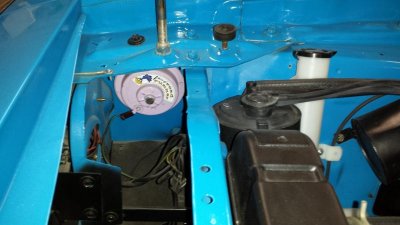

Here is where the horn goes on a 72. Pass side in front of the core support. 71 it is was pass side in back of the core support but they moved to in front of the core to make room for the vapor canister in 72.

For ’72 thru ’74 there was not a “GTX” option that could be ordered as such, the option that made them the dual named/dual badged “Road Runner GTX” was the 440 engine option only. All “U” coded, and the hand full of “V” coded, Road Runner GTXs would have come with a single Road Runner horn. All forward lighting wire harnesses were the same for all 2 door models with provisions for two horns. Any other model would have had a standard dual tone horns. All '72 fenders have a total of 2 horn mounting locations per fender, total of four as pictured. Mine was originally installed on the pass side but in the other fender mount location than what is pictured above.
This has been debated to the point I dug my build sheet out to check for special coding for horns. There was no special code listed. So I am going with it is a RR with a Beep Beep horn and some one put in a regular horn to fill the space. Only have 2 locations for horn mounting both located is in post 10 but opposing fenders. This combination sounds weird and will eventually put in another beep beep as I really do not give a crap for number matching just do not try to pass your fake off to be some thing it is not.

To clarify the ’72 mounting location, as moparmarks has indicated, the horns were moved in ’72 to forward of the core support to make room for the charcoal canister. The fenders were stamped with horn mounting holes the ’71 fenders did not have. Required the horn brackets to be changed as well so that the bolts now passed through the fenders and into treads in the brackets, short RR horn brackets ’72 on. To insure the electrical connection to the body the factory used a horn bolt with a captured washer with teeth that leave distinctive marks where they have been used. Example; as with one of my current ’72 cars with original fenders, out of the four possible locations for the horns there was only one with teeth marks. Tells me a single horn and just which location it left the factory in, besides the original paint showing.
