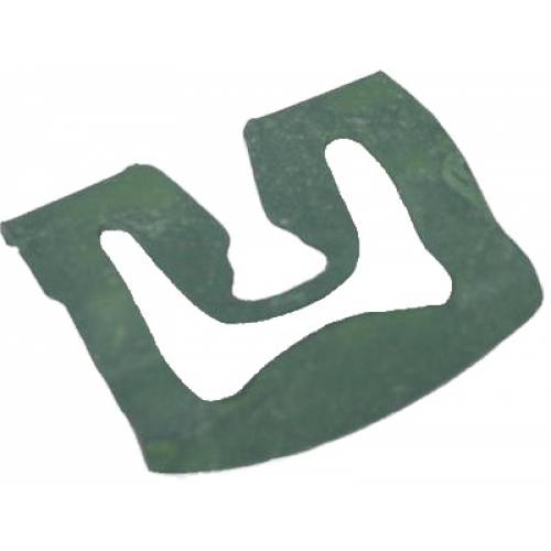

I have a piece of trim around the rear glass that pops loose because the clip is broken. Can these clips be replaced without removing the glass?
If the original stud that the clip snaps onto is still present, the correct replacement clip can be installed without removing the glass. May have to carefully dig out any sealant, that may have been added over the years, from around the clip to free any remnants of the old broken clip.
Thanks!
