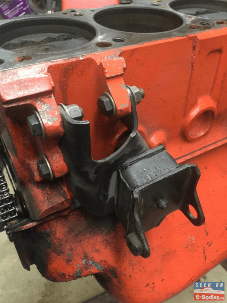

engine mounts as mentioned were changed between 72 and 73.
while up to 72 were like these, two separated pieces and the rubber block between them:
Since 73 they were like these... a single metal bracket and the bushing kind rubber mount.
and with a crossing bolt, accomodates like this onto the K frame provisions
