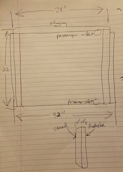

I'm going to replace or fix my existing radiator it just depends on how much they charge me to fix the top seam. My question is almost all the oem or aluminum ones show dimensions that don't seem to jive with what I'm measuring on my car here's a crude drawing lol. If any of you can help me out I'd appreciate it. And what about the stock shroud I want to keep that I don't want to go to electric fans.

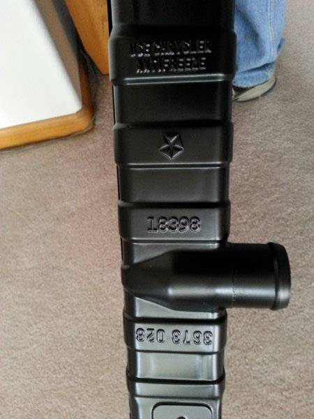

What are the numbers stamped on top of the radiator? If its like mine, and a 28" radiator, they are hard to come by. Here is the number that were on top of mine. The part number was 3673028, indicating a 28" size. I had Glenn Ray rebuild mine.

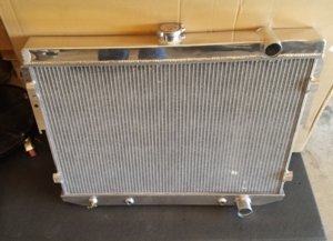

Correct I do want to try and save mine but that link to the ebay one that's awfully cheap for a radiator wow. When there that cheap you have to question the quality and performance of it don't you. The cold case one's intrigue me just because they look just like the stock ones but in aluminum pretty cool.

Hello,
Sorry but it doesn't look like we do. We don't have any Mopar radiators with both passenger side outlets.
If you can change the plumbing, we can probably help.
Must not be an original Chrysler radiator, likely aftermarket if no part number or Chrysler stamp.
I was able to pull the radiator tonight and didn't find any numbers except 3 numbers that said 505 which I have know idea what there for. So you are right its not and original plus it looks like on another part of the same seam they used epoxy or some thing it just doesn't look right . I'm going to take it to a radiator repair place and see how much it will cost if its more than $200.00 I'll just by and aluminium one I guess.
