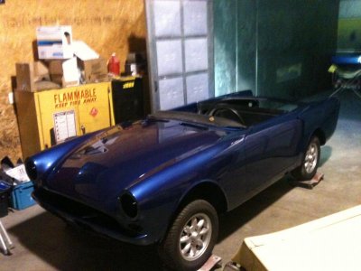

I tried Wizard and they don't show the radiator with the inlet and outlet on the passenger side , but I did find a radiator for the Sunbeam I am restoring for my Dad , thanks !

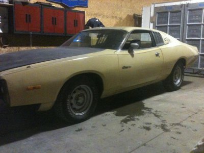

Not sure if you guys have seen my thread on my car but it's sort of a pile of junk , it's come a long way after dragging it out of the mud but my budget for this is only $300 tops
My next post will be comparing the replacement I ordered to my original
my pile ...
That does not look like a pile at all, looks pretty solid to me.

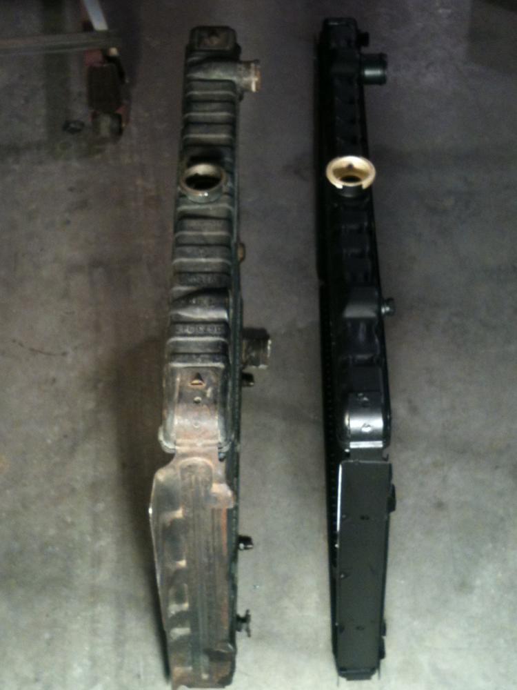

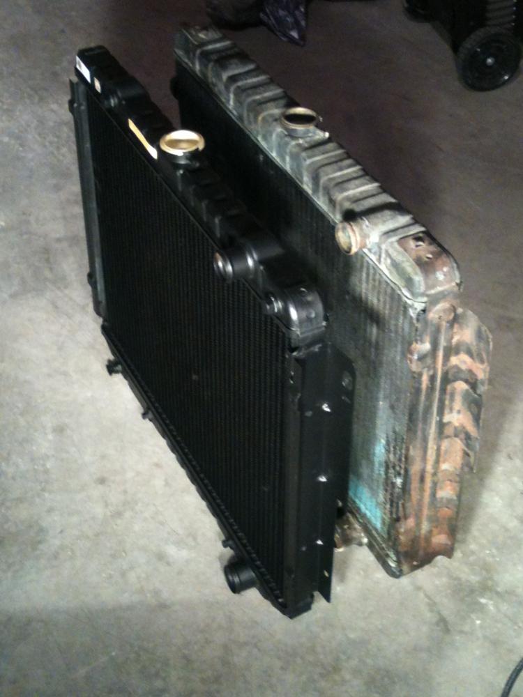

The "Pro" radiator from Rock Auto is a pretty good replacement , it is copper/brass and mounts as the original , but as you can see it has smaller tanks. I also noticed it has 4 less rows of cooling tubes than the stock 28 that is the original radiator.
I did try another shop for my tired original and watched the psi test , it leaked at the header plates and the core also , I got estimates of 450-500 $ depending if I wanted to go 2 or 3 core.

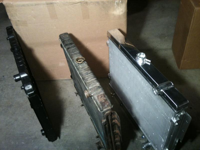

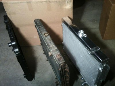

I have totally explored all my options so far and decided to order up a champion radiator , I ordered it from Jegs for like 225$ or something.
Once I recieve the aluminum radiator I can compare the two offshore replacements and decide from there.
As far as looking original, that really is out the window for this car aka "Joe Dirt" , with the fiberglass hood and headers , I think I am better off to err on the side of better cooling than looks.

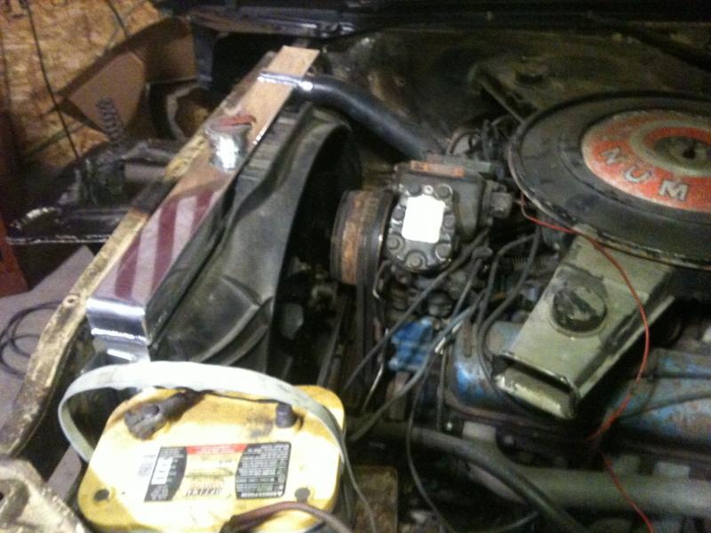

The Champion Radiator looks great and fit great , all I had to do was trim the original shroud at the top by the filler neck. I cut 1/2 inch off.
The Pro from Rock Auto was decent for a regular driver car , but it was also about 25$ more than the Champion from Jegs
I also added a MP viscous fan package versus the huge fan and clutch that was on the car. It is only a lot driver ( no lights on the car , so it will be a few months before I have it on the road to give driving impressions )
