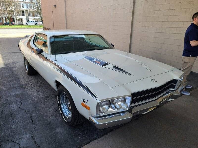

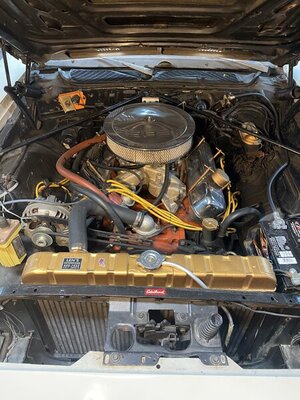

My father passed away a few weeks ago and I inherited his 1973 Roadrunner. The car was not driven for a year due to his condition and not being able to drive. I cleaned it up and have been running it.
When he was driving it the Temp and Oil pressure gauge stopped working, we had our mechanic replace the voltage limiter which we thought was the problem but they still do not work.
We also wanted to replace the radiator with something a little more modern because it tends to run a little on the hotter side.
I want to keep this car and have it running solid, any help would be greatly appreciated.

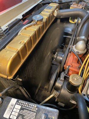

(Assuming the car is stock and the radiator isn't damaged) i would probably start off by flushing/cleaning the cooling system and installing a new thermostat. That's just a couple bucks and might fix the "running a little on the hotter side" issue. If not you can still try the more expensive / invasive stuff...

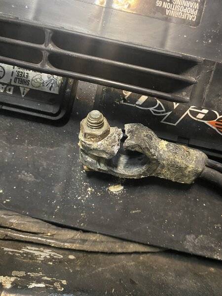

Welcome to FBBO. Did your mechanic check voltage at both oil pressure and temperature sending units with a volt meter. And your grounds are good. That’s where I would start. Just a quick temp gauge check would be touch the wire going to the temp sending unit to ground and see if the temp gauge needle moves. (Should peg the gauge) Both sending units are easy to replace and fairly cheap.
Also check battery terminals and make sure they’re clean and making good connections.

Battery cables corrode so I would inspect them to see if any oxidation has crept in from a crack in the insulation or one of the ends. Also be sure your ground cable is clean and secured.
Ditto those who suggested having the radiator cleaned/ flushed. I'd be tempted to bring it to a radiator shop and have it boiled out and tested before buying a new one.

Thank you for all the advice, I did notice that the battery cables had some corrosion, I will take care of that and see if it changes anything. We went from 70 and nice to 30 and possible snow tonight... Hopefully the weekend is better so i can spend some time on it. Here is a picture of the rear, I need to take more pictures, these were taken at the viewing... I spent 2 days with my Uncle detailing every inch of the car.

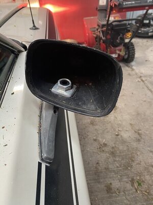

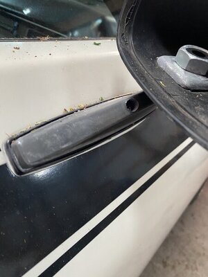

So I was removing the battery and the parts store was closed, so I was placing it back till they reopened and the following happened, I purchased a new cable and have it installed. If I remove the bottom radiator hose and run a garden hose through the top, is that OK to flush the system?
