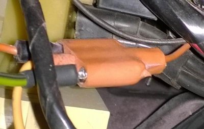

As ODZKing says, the orange molded plug is for lights, the red one is an accessory feed direct to battery buss. You can use the accessory feed on the fuse block, its the one on the lower left side and switched with the key, the right side one on the fuse block is direct to battery buss. Just a note, the yellow molded plug is an accessory feed, used for ac/heater control, rear defogger, and optional factory tachometer, and it is tied into the accessory buss.
