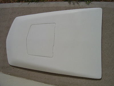

Hello, I'm brand new to this forum. I found a fiberglass air grabber hood bulge with door that glues on to the hood on ebay. Will this fit on a 1973 Satellite Sebring Plus with a straight hood?
This is what I'm looking at on ebay. Says it's for a 71/72 rr.
unfortunately no it won't
Welcome from the show me state!!
71/72 hoods have a ridge and a depression that fits the shape of that A/G bulge.
Your 73/74 flat hood has a ridge down the center for one thing.....
However...71/72 hoods bolt on and close on 73/74 cars and vice versa.
There is a small area on each side of the front lip of the 73/74 hood that is at a slightly different level (like 3/16ths).
