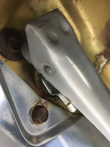

I can't seem to get the wiper arm seated enough on the splined shaft to engage the locking tab. How much force is necessary? Am I missing something?
It should not take much at all. Make sure the splines are clean on both the arm and the shaft, and that there are not any burrs on either. You can use just a touch of white grease to slide on the arm as well, but usually not needed. Also make sure you have the arm on straight and not at an angle, that will prevent you from seating the tabs.
Is the locking tab pulled out? If not it will keep the arm from going on.
Got it, I had to put a screwdriver to pry the hinge spring a bit so it would start straight.

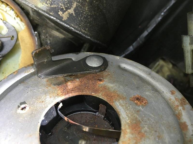

3-speed motor not reversing? Pull the switch plate/cover off the motor, note the location of the locating tab beforehand, clean-up the contacts on the switch plate park switch with some emery cloth. Reassemble with the locating tab as it was.

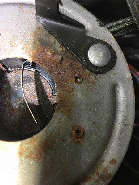

I really appreciate all the help on this. I took the switch apart and it looks like the contact has disintegrated. Is that small contact ribbon supposed to have something on the end?
3271232F-4E87-4AFD-89EA-E7A8D26B8A39.jpeg D6667594-0806-4D90-8E42-FF1B835174D9.jpeg
While I am at it, should I just do the shaft too? It looks like the kit comes with one.
I noted the position of the clocking marker, do I need to do anything else if I remove the motor from the firewall? Do I need to mark all the moving parts of the gearbox and switch assembly?

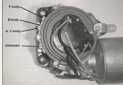

That kit was originally intended to be a retrofit kit for the earlier park switch design. If installing the kit on an older motor, the shaft would need to be changed out. It appears your wiper motor already uses the newer design; it should not be necessary to replace the shaft as you would have the same shaft installed now. Nothing else should be needed to replace the switch plate, some soldering will be needed. Be sure to clock it as you found the original. The clocking adjustment allows the motor to be used on other vehicle platforms where the wiper parking position may be different than the B-body.
Should you choose to remove the motor for easier access, just remove the bell crank nut, bell crank is indexed to only go on one way. Hard to mess it up.
It also appears to me that a portion of contacts may have broken off and may still be in and around the gear housing. I would see if you can locate it, remove it.
Picture labeling for reference only, can’t verify the accuracy.
