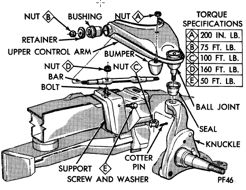

I bought a rebuild kit and was wondering if those upper bumpers are even needed as I didn't see any while disassmbling the suspension. If yes, where are they located?

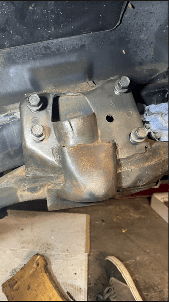

That's how it looked completely disassembled:
There seems to be no mount for said bumper.
I found this in the chassis manual:
There's the bumper but in my upper control arm, there was just a plastic disc, not the actual bumper
Pop the disc out and bolt the bumper there. Is the disc bolted on? Perhaps the old bumper dry rotted and fell off.
Yep, it's bolted on (Sorry, no pic from below at the moment):
But it looks like it's supposed to be there. Too clean to have fallen off.

Yes.
They stop metal to metal contact if the suspension bottoms or hyper-extends.
...and at 100 Ft/Lbs, it's the tightest (and smallest) thing on there.
It's not plastic it is the metal plate that the rubber was attached to...the rubber part has fallen off.

Quote,: "and at 100 Ft/Lbs, it's the tightest (and smallest) thing on there." end quote. Actually its 200 inch pounds according to the FSM picture.
oops, saw the "C" nearby and missed the line to "A".
Hope I didn't crank mine to 100
Tight is the proper torque. You can use a combination wrench, a ratchet and a socket, or a impact tool as long as you know when to let off the trigger.
