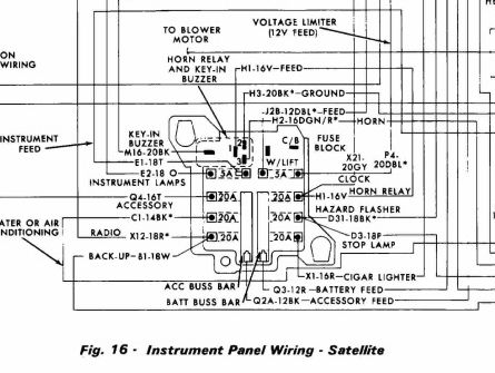

Does a 73 Satellite Sebring have one ?
I'm trying to get my horns to work to no avail.
I see a spot on the fuse block that appears to be a relay location, but can't tell.
Is there supposed to be a relay installed in the spot labeled " horn relay and key in buzzer" ?

Yes, my 73 RR has one in that position on the fuse block. And the "Circuit 2" fuse is for the horn (20 amps). The metal-case relay is rectangular matching the outline in your diagram. Mine stopped working for the "key-in" buzzer. But I couldn't find a replacement one--problem was matching the pin configuration. Good luck--maybe someone else can point you to a source for them.
