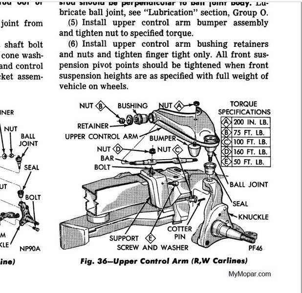

At work and don't have access to my shop manuals. Can someone please let me know what the torque spec is for the cross shaft nuts that squeeze the UPC bushings is. Not the adjustment bolts, just the cross shaft end nuts. Vehicle is a 73 Roadrunner. For some reason 75 ft/lbs comes to mind but I want to be sure. Thanks in advance
75 ft/lb is correct...

As originally posted, I have the shop manuals but did not have access to them while at work, and I needed a quick answer for the shop doing an alignment. If I could have found it on the web I would not have asked for the information. Simple question and 69Bee gave a timely answer that saved some headache and I thanked him for the information. When at home and having access to 71,72, and 73 manuals, I routinely answer these types of questions if the answer one seeks is in those manuals. I don't consider it a big deal to help someone out if I have the information they need. But that is just the helping person that I am and I kinda like that.
The rest of the story. It was at a shop doing an alignment. Didn't say that.
It is online. I have all of my manuals online. I store them in a folder in my computer for quick reference and to print a page or section if I need it. No books to take care of or haul around.
Keep this link in your wallet in case you need another service away from home.
https://mymopar.com/resource-library/
