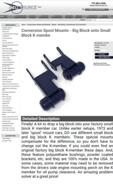

This is what I found out when I spoke to someone at Schumacher. It may be a couple of months before they do a production run on the BB K to a SB K conversion kit. However, they do have a SB K to BB K conversion in stock, and they offer the SB K to Gen. 3 Hemi conversion.

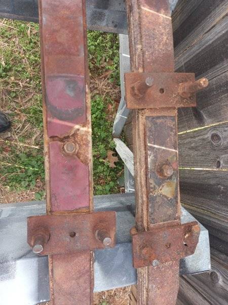

1. Can someone please provide me info on the operational difference between the Heavy Duty and Standard Duty rear leaf springs. We found one of the heavy-duty Leafs (Top to bottom number 7 leaf) broken.
Question 2: Is there any aftermarket replacement individual springs to repair this?
Question 3: What is the ride height difference between the Standard and Heavy-Duty Leafs?
I have 2 additional sets of standard Leafs, so we could use one of these sets, but I am wanting to assure of the ride height and performance difference, if any before I make a decision.

Operation difference is the ability to more comfortably carry more in the rear of the car, or use a heavier trailer (tongue weight) if that's needed for you. Of course, if you went with a really heavy leaf, then rider comfort can begin to suffer.
Ride height should be very, very close to stock specs in an unladen vehicle. When buying leafs, you can now specify ride height over/under stock spec, or use differing front and rear hangers to accomplish your goals. I would suggest a call Espo Springs and Things for whole new leafs...., since if you have one broke, they are all indeed tired and weaker. You may find them quite affordable there. Good Luck.
