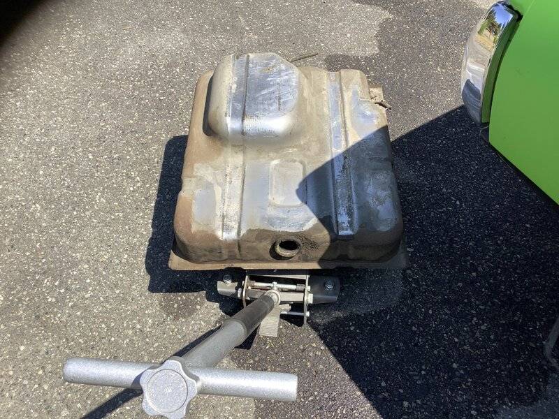

I've searched and searched but can't seem to find a '74 Charger tank ready for internal electric fuel pump to feed EFI.
Do I have to go custom build, modify my existing almost new tank, or have I just plain missed one already out there during my searches?
Any help would be really appreciated!!

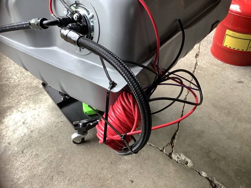

You can modify your new tank or buy one like BeepBeep stated.

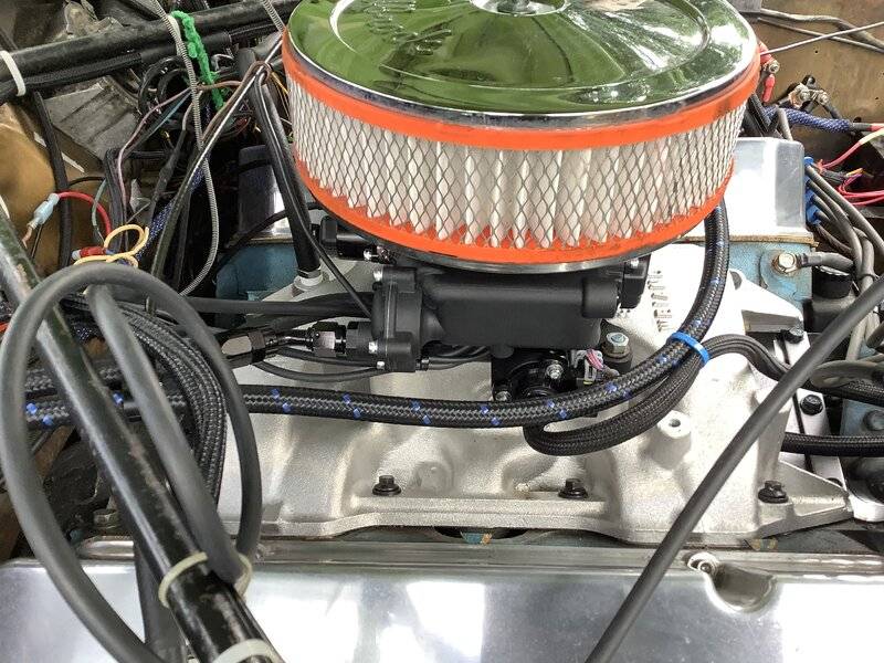

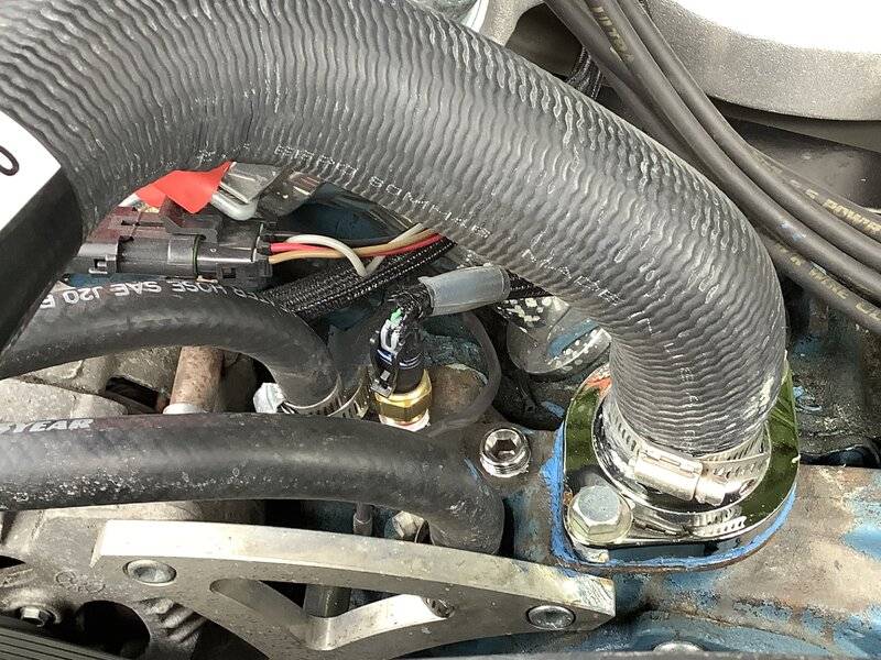

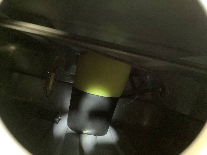

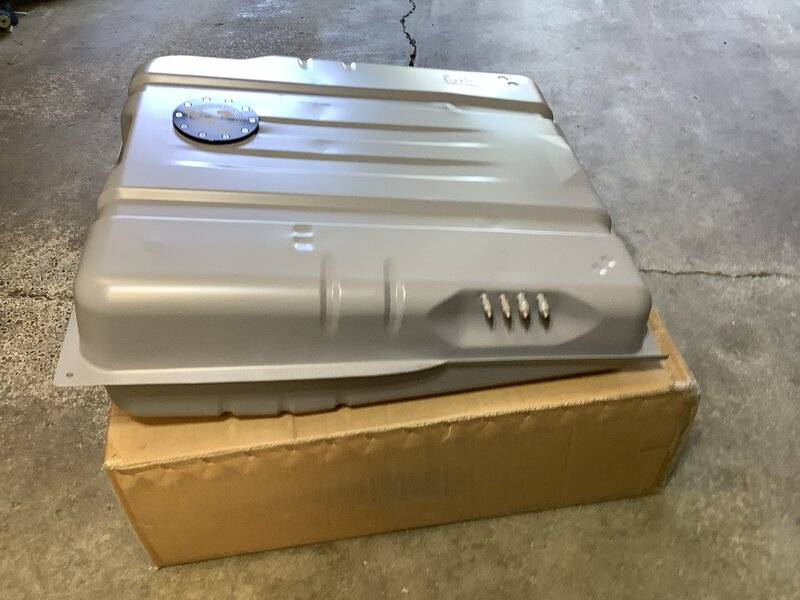

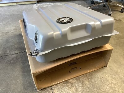

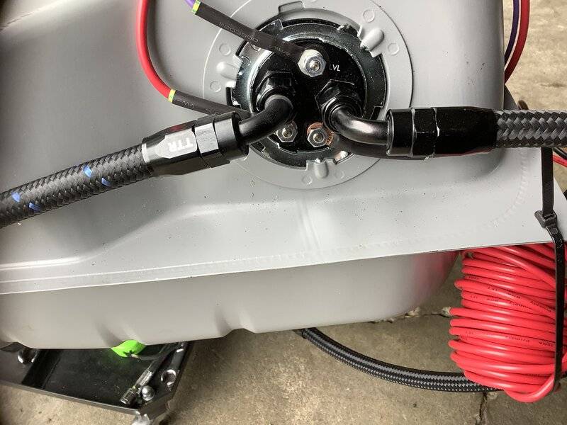

I went with an efi tank w/pump for 71-72 Charger and went right in my 74 Charger. Plays nice with sniper system.

Thanks to everyone for your help. I thought losing the '74 hump would not be an issue but still didn't know if the tank would fit in the space.
64fury74charger; which fuel pump did you choose. From the one photo you posted I expect it's one of the higher flow rate pumps. I'm running a pretty much stock 400 so the 200lph unit should more than satisfy my needs. Do you know what psi these pumps produce? I'm leaning toward the SNIPER myself but would sure like to know the PSI. Holley seems to fixate on that some in their install instructions.

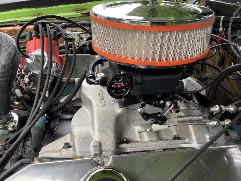

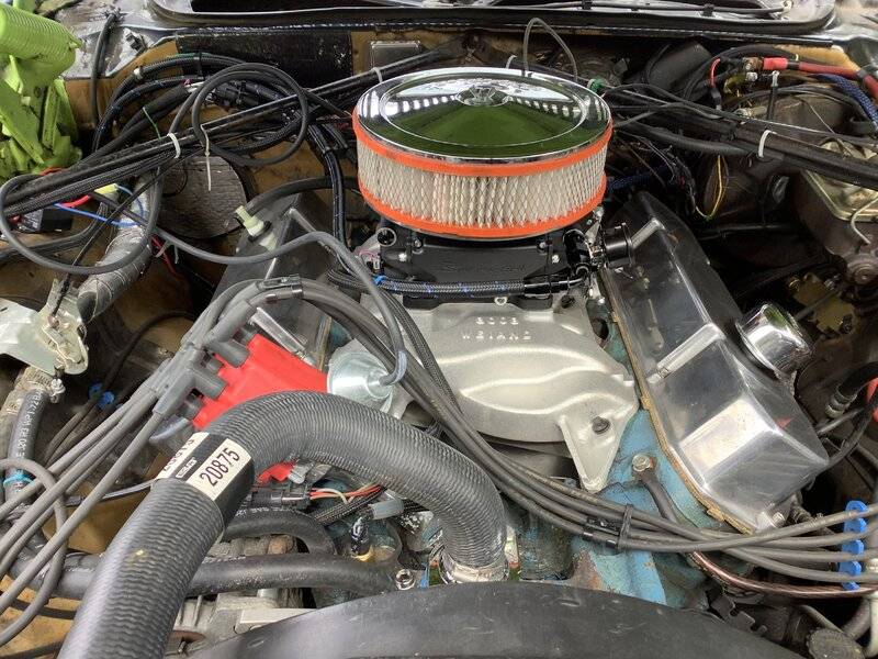

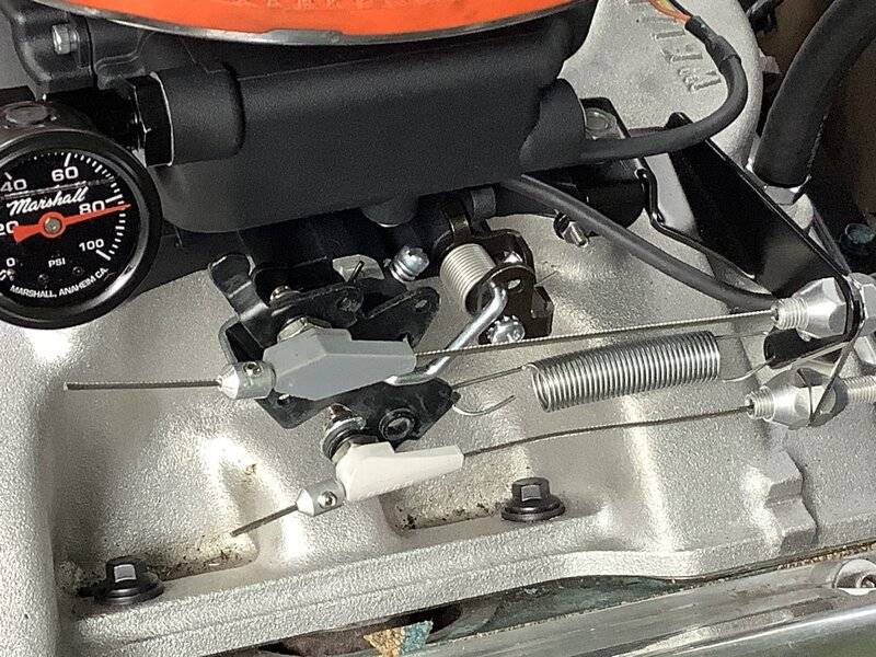

I have the lowest number it comes with and I have a fuel pressure gauge on the tbi inlet that consistently reads around 85 psi going in and the sniper has a built in regulator that’s supposed to be around 58.5 psi. My motor is also pretty much stock 78 400 with headers and weiand hi rise intake. Hope this helps you get some ideas.

Standard size opening like any Edelbrock, TQ or Holley carburetor. I am looking into making an air duct and putting a cone filter inside the front bumper area but do not want to cut into the core support.

There are 4 vent tubes on the efi tank on the left rear side. I did not use any and just have a loose fitting “vented “old locking gas cap that I put on the car about 15 years ago . Seems like it is working so far and the tank is actually dry on the outside and not seeping any fuel out. Nice not having any fuel odor at all under the *** end and zero under the hood is also nice. Hope this helps you. :thumbsup:

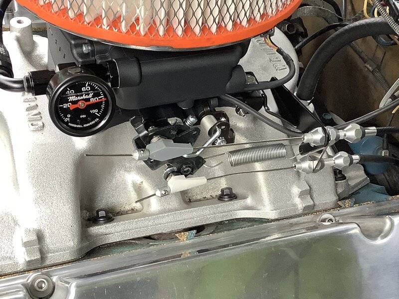

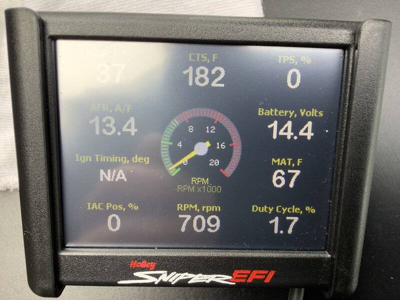

I went through a lot of stages trying to figure out how it would work before diving in. Once the decision was made then ordered the parts and put the tank and line in first and the efi was really easy. I used Lokar cables for throttle and kick down which really cleans up clutter and clunky linkage under the hood. Starting is simply letting the handheld load and turn the key. Car can sit for three months and starts right now.

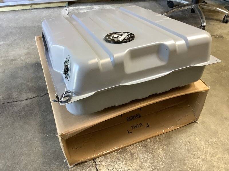

I'm thinking of putting an EFI tank in mine. Currently has a fuel cell in the trunk, but I want my trunk space back.
I'm thinking of using a Spectra CR10A tank ($250), with a modified Spectra FG93A 3/8" sending unit ($88 + $20 for electric bulkhead connectors) connected to a walbro pump. The 450 lph E-85 pump I plan to use is $120.
https://www.summitracing.com/parts/...7QUbl7y-ngLH-bw5C8enHY1Yi8SQB1c0aAkD0EALw_wcB
Likely will end up with around $500 into the setup? Maybe $187 more if I use Holleys 2.5"x8" #16-116 Hydromat.
The 1/4" return in the FG93A sending unit might (likely) need to be changed to a 5/16" or 3/8"?
Looking at the Aeromotive 340 lph tank ($650) seems like a good deal in comparison?

Just my opinion, but I would prefer to get a proper tank with the fuel pump in the tank as it keeps it cooler and helps it last longer. Also has your sending unit and all that already sorted.
However, doing your set up is a bit easier to put together and likely to work on as you can get to pump if needed.

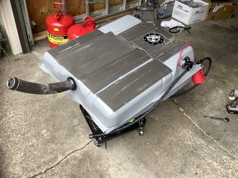

This is internal pump, like the Holley RetroFit kit for the 1970 Charger. They just don't make one for the 1971-and up charger.
https://www.holley.com/products/fue...uel_pumps/muscle_car_efi_modules/parts/12-384
Main difference is I will have a return line, not built in pressure regulator.

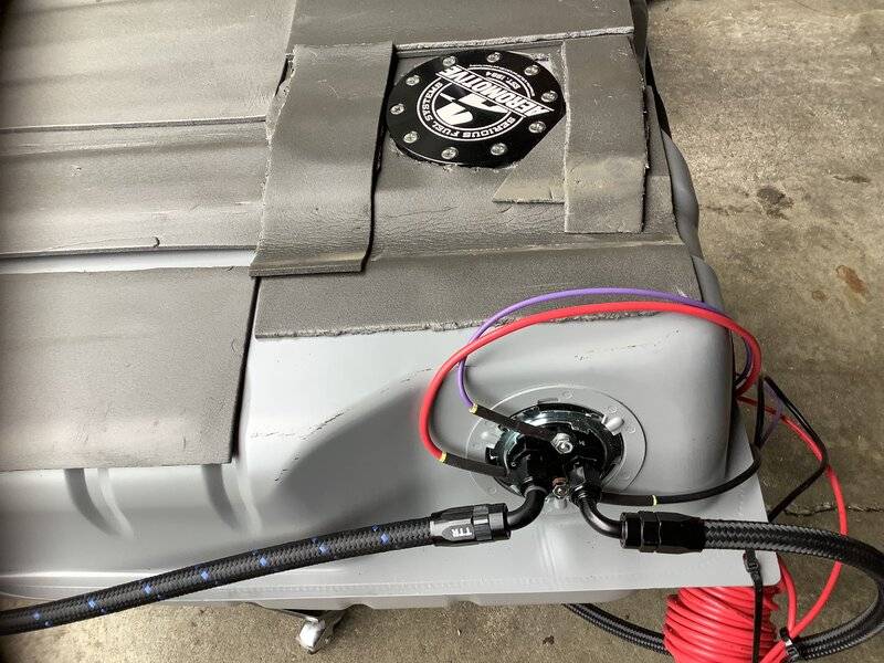

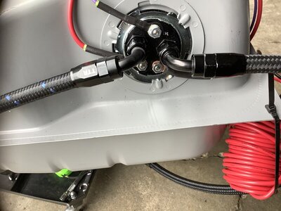

I went with the earlier complete tank after really thinking about putting a fuel cell in the trunk. Also tried to work out buying the “correct “ tank and cutting into the tank and installing pump and clearing the sending unit float. For both price and time and potentially destroying a brand new tank I went with Aeromotive tank and so far everything is playing together better than I expected.
