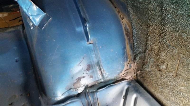

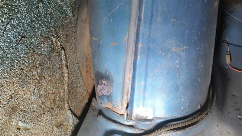

Now this is something I never noticed before but maybe others have. The rear wheelhouses are different widths at the rear on each side on both of my 74 Chargers. This makes for a different gap between the wheelhouse and rear quarter panel. At first I thought maybe the rear had been hit but the seam sealer is intact. Compared both
Chargers and they're the same. See photos. Do the 71 to 73 Chargers and the different 71 to 74 B-bodies Have this same oddity? It looks strange.

Charger Blue driver Side Wheelhouse (Medium).jpg Charger Blue Wheelhouse Passenger side (Medium).jpg
they are like that all the way to 1979. i think it started in 73. couldn't tell you why, maybe something to do with the fuel tank and lines, not sure though.
It's strange. I've had my Charger for 30 years and never paid attention to the wheelhouse on either side. I actually looked closely thinking the car had been in an accident and repaired before I got it in 1987. Nope.

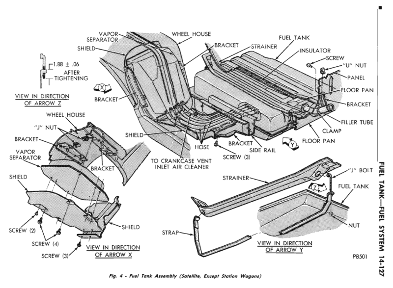

You are likely seeing the differences in the wheel tubs due to the original lactation of the ’71 and early ‘72 fuel tank vapor separator in the driver’s side aft wheel well. Stampings were carried through to the end of the platform.

The OP’s question by understanding is in regards to the asymmetrical appearance of the rear wheel wells from left to right. Fact is the left well is larger, extending reward to originally accommodate the larger fuel tank vapor separator/expansion tank that was mounted in the left rear well beginning with model year 1971 and through March 1972 (early model year 1972). If you have a ’72 with the small front mounted fuel tank vapor separator, it was built after March 1972. After moving the separator forward of the fuel tank in mid-’72 production, the same wheel well stampings were likely used through ’74.

Front of the well? The early separator mounted to the rear of the left rear wheel well, aft of the wheel. Nothing to do with width, the well is extended rearward, by about 2-3” as compared to the right side well, to accommodate the ’71 and early ’72 well mounted separator.
'71 and early '72

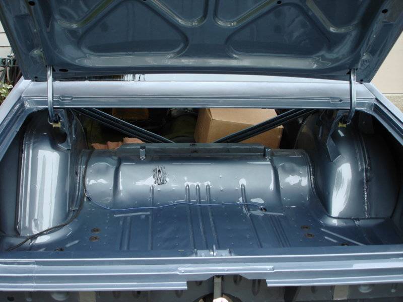

73’s are definitely different sizes. I built custom subwoofer enclosures that fit into the trunk around the wheel wells and each one was significantly different
