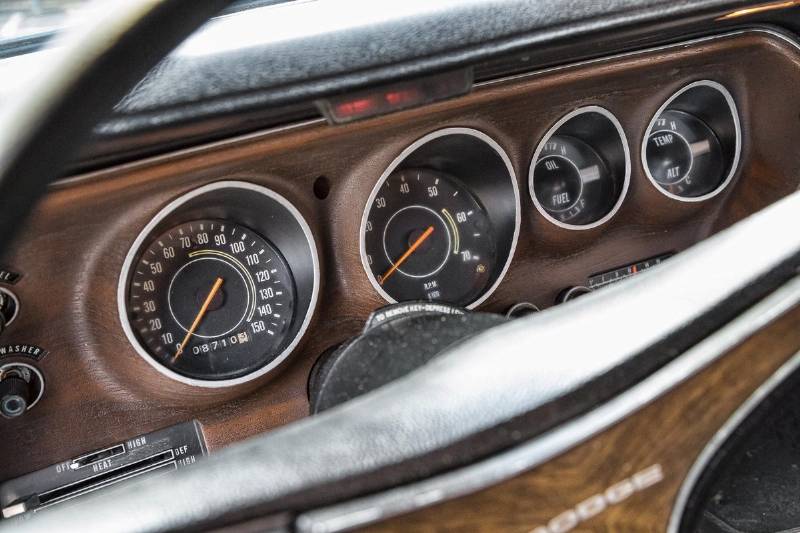

So, what am I looking at? A factory tachometer with a lens from the factory clock (J21 and mind the hole for the adjustment knob) which came with the factory A76 Brougham package? Or...

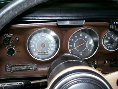

Yes that’s right. The covers are the same. The tachs came with a little plastic plug in the hole where the clock adjustment shaft would be
as mentioned… same lense mask, but tipically got a clear plastic plug ( tipically yellowed ) into the hole for tach cars.
Two lenses masks were available… the ones for the basic Rallye cluster, and the ones for Tach/clock

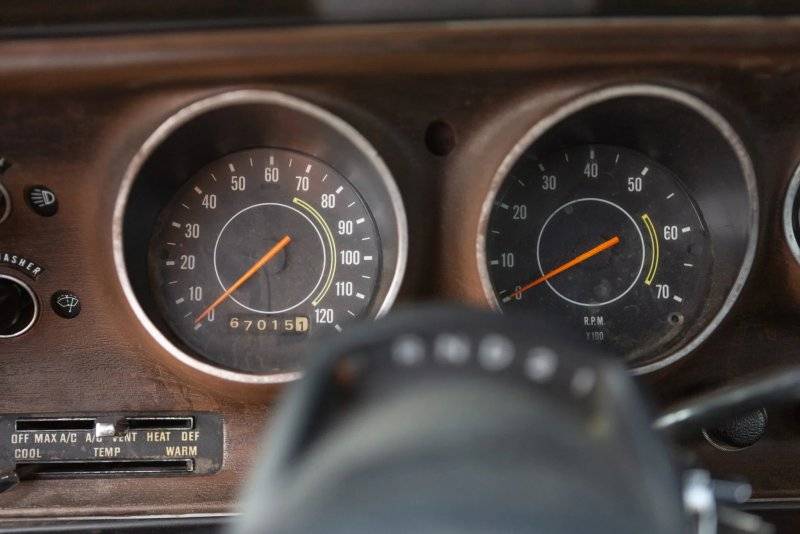

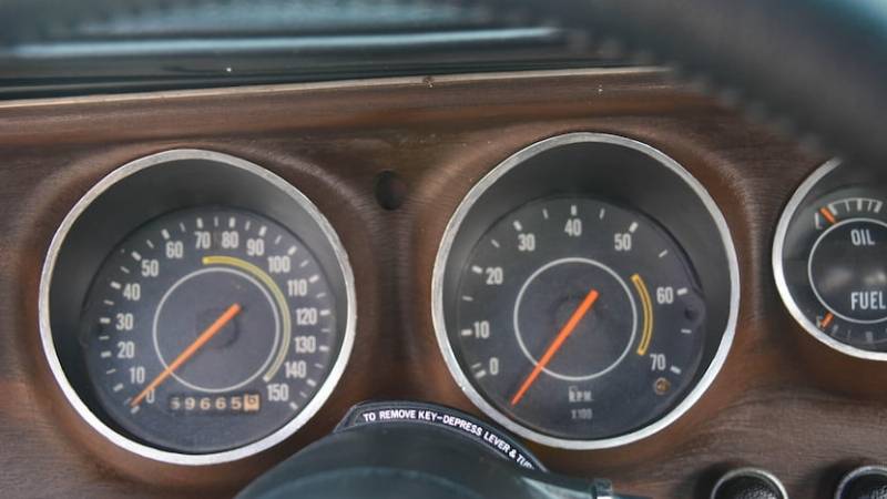

HOWEVER I have seen some cars without the hole on lense for tach cars. Dunno if lense was replaced on them or not.

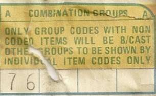

Well, I think that if a car is produced as SE (rallye cluster as standard), with the option tachometer, but with the Brougham package (standard with clock option) will always have a hole and a plug? A kind of production line/option list inconsistency? I don't have the tachometer option on my buildsheet...

I think these cars were not with the Brougham package then?
