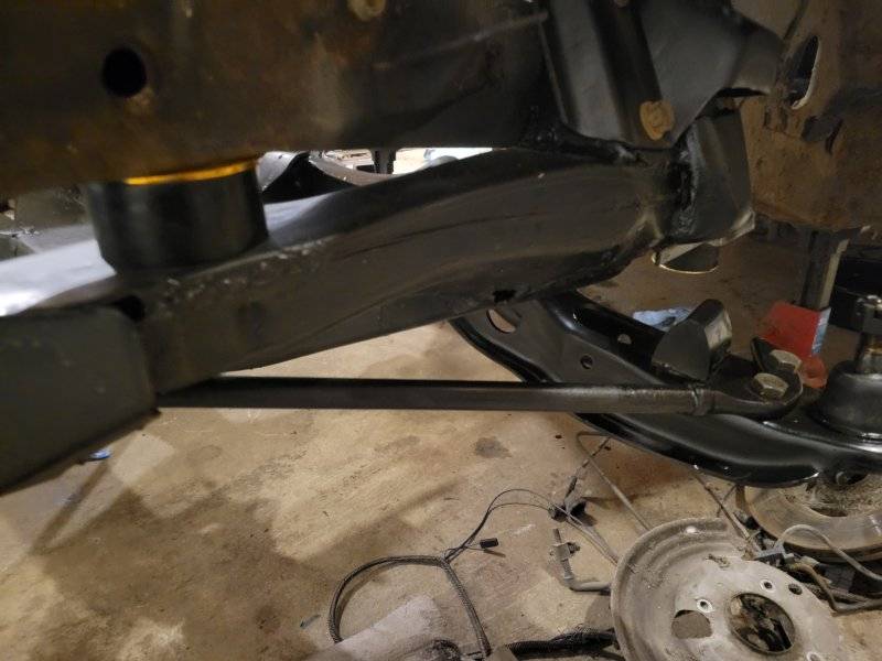

What rubber mounts are those that you replaced on the k frame?
Poly K Member mounts from Mancini Racing.
I cleaned everything one piece at a time and re assembled and I am torquing everything back to Factory Specs.
I also added Poly mounts on the sway bar.

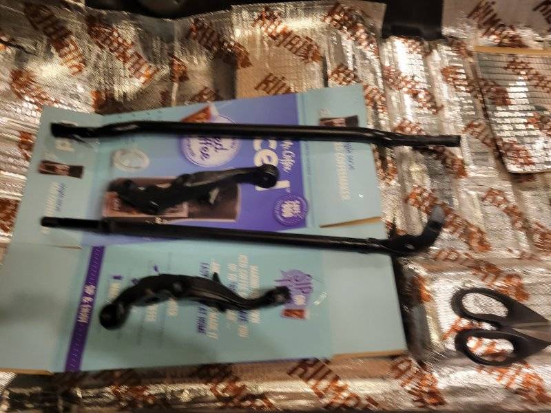

Brakes and new tie rod ends installed and installed sound deadener in the roof.

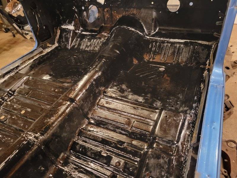

Floor look a lot cleaner this was what I did before adding sound deadener.
I did this to preserve the floor it was solid and I want it to last another 40 plus yrs.
