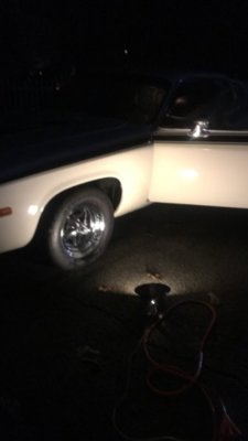

After the overcenter spring came brakes, and then the car was roadworthy!
(I had a short clip of the exhaust when we had it running last November, but it seems it's too large to upload. I will have to create a youtube account and edit this post later to add it in.)
With the car running, it was apparent that there was something else wrong with the engine; we were getting a heavy smoke from the driver's side exhaust pipe. Paired with a leaky exhaust manifold the car was drivable but only just. With winter imminent, our build was on hold - come spring 2019, we would start down the path that led to where we are today - engine rebuilt and car disassembled once more.
