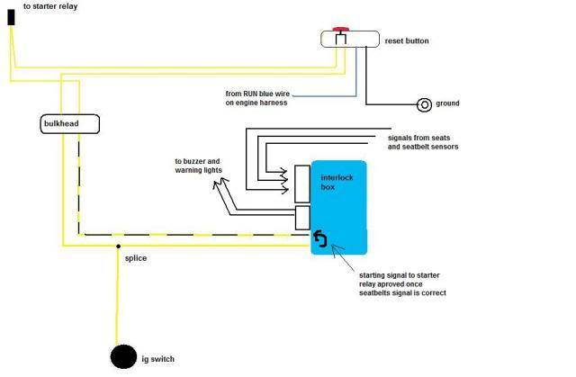

if its not in the nss or its wiring (which is what i would suspect first and foremost)
it could be the seatbelt interlock that came on 73 and 74's
is there a small box wired in on your inner fender that has a reset button?
hit that button and see what it does.
or is part of that system missing on your harness?
you can bypass that system in a few ways.. even pull the wires off
the sensor on the seat or jump the yellow wires going into that box
or you can even move a few wires on the bulkhead and eliminate the whole thing
see what any of that does for ya...

I had this same problem! We also checked EVERYTHING 3 times. It turned out to be the seat belt/ignition cut off system. Only 74s had this stupid thing, I think. There were wires under the bench seat and unless you buckled your seat belt after being seated, it cut off the ignition switch and wouldn't start.
Since I took my bench seat out, I just bypassed it with a push button start under the dash. I had no idea what it was until I was recovering the sun visor and read the instructions on how to start the car. Crazy.
Alex
HEY!!! THATS MY DIAGRAM!!! LOL :headbang:

just a note... if you have the seatbelt warning signal activated, it simply won't start. If you fastened correctly your seatbelt, That's a signal the some sensor on system could fail OR interlock box is gone... which is hard to find ( I KNOW IT )
Begins to press ( or bypass ) the reset button... if doesn't crank that will tell you is an NSS, Tranny linkage, or NSS Harness failure.
reset button works for a while you try to crank untill success... then the RUN circuit will deactivate the reset button
More info with a link to a video at the end:
http://wichargerguy.proboards.com/index.cgi?action=display&board=archives&thread=999&page=1#7583
sometimes you can find a bypassed buy dealer interlock blue ( auto ) or white ( manual ) control.
if you want to rid off the interlock system but still keep the warning signals, get an orange ( Canadian ) or green ( 75 and lates ) control box, these were not interlocked.
Last time I checked found a green box on ebay... also a blue box but AMC which I'm not sure is the same code for Mopars ( being for auto ). I think found also a white piece.
If you don't care a $**T the warning signals, simply jum it out the yellow wire at reset button on engine bay ( that will bypass the system )
note: the control box, controls ALL the warning systems, not just seatbelt, also lights on and key in buzzer
