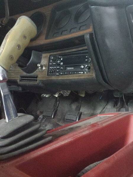

I put a 0verdrive 833 in my 78 magnum xe 400. And a 9.25 sure grip with 3:21 gears....not quite finished yet ..but lots of work!
Nice conversion, you have a one of kind Charger. Small or large block? Need any parts?
