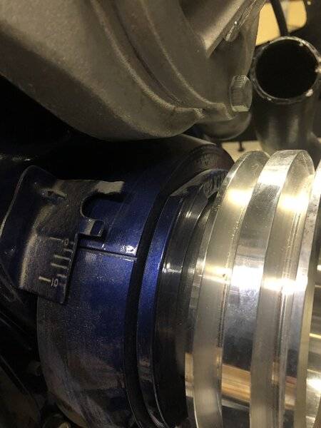

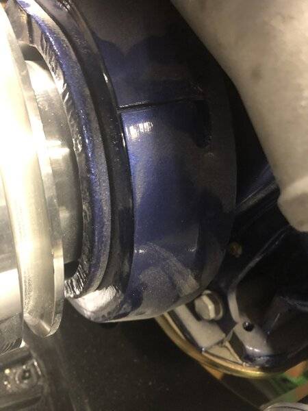

what does the front balancer look like? if its not been rebalanced for internal it will shake with no weight on the rear of the engine. needs to be figured out before you run it.
884DF7F7-D74D-401F-B246-1667FF3FB38D.jpeg C9062C10-BA51-44E3-9D74-68631C9DEC68.jpeg
You need an externally balanced flywheel for a 440 with a cast crankshaft. That balancer has the offset weight on it, and the crankshaft needs to also. If you will run an automatic behind in in the car, make sure the converter has the weight on it. Throw that additive and oil in the garbage and get proper break-in zinc oil from: Joe Gibbs Driven, Amsoil, Brad Penn, Royal Purple, et al... After you break the motor in, change to a high zinc oil from any of these manufacturers. Don't use the additive, as you can cause yourself problems, just use the zinc oil with it mixed properly and at the proper levels from the start.
