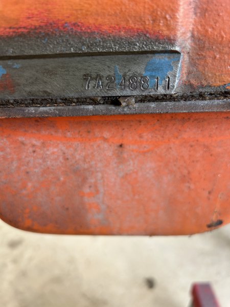

The 4006630 was used 75-78. Any stamped numbers above the pan rail?

Got to the oil pan rail numbers today:
Confirmed the bore is 4.30 so it must have 50thou. wear and never bored. The stroke is 3.71”. I’ll drop the pan next and will add those photos.
