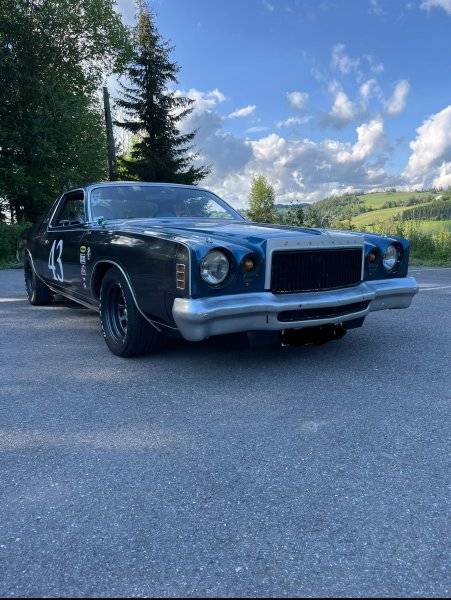

Hey, new to this forum and i wanted to make a post about my project this winter and the progress i have so far.
My car is a 1977 Chrysler Cordoba with a 400, 727 and 8.25 rear axle that i bought earlier this year, the car is in good condition except for a few minor rust spots here and there and the engine and gearbox is leaking and using a bit of oil. thats why i have decided to rebuild the engine and gearbox.

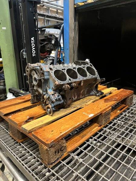

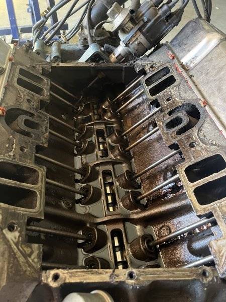

So far the project is going quite good the engine is out and have been taken apart without any major surprises. the engine has low mileage (75k miles) and not to much wear on anything, however i was missing one piston ring, the rod bearings had copper colour on it and the rear main seal was in quite bad condition so the engine was in need of some service.
